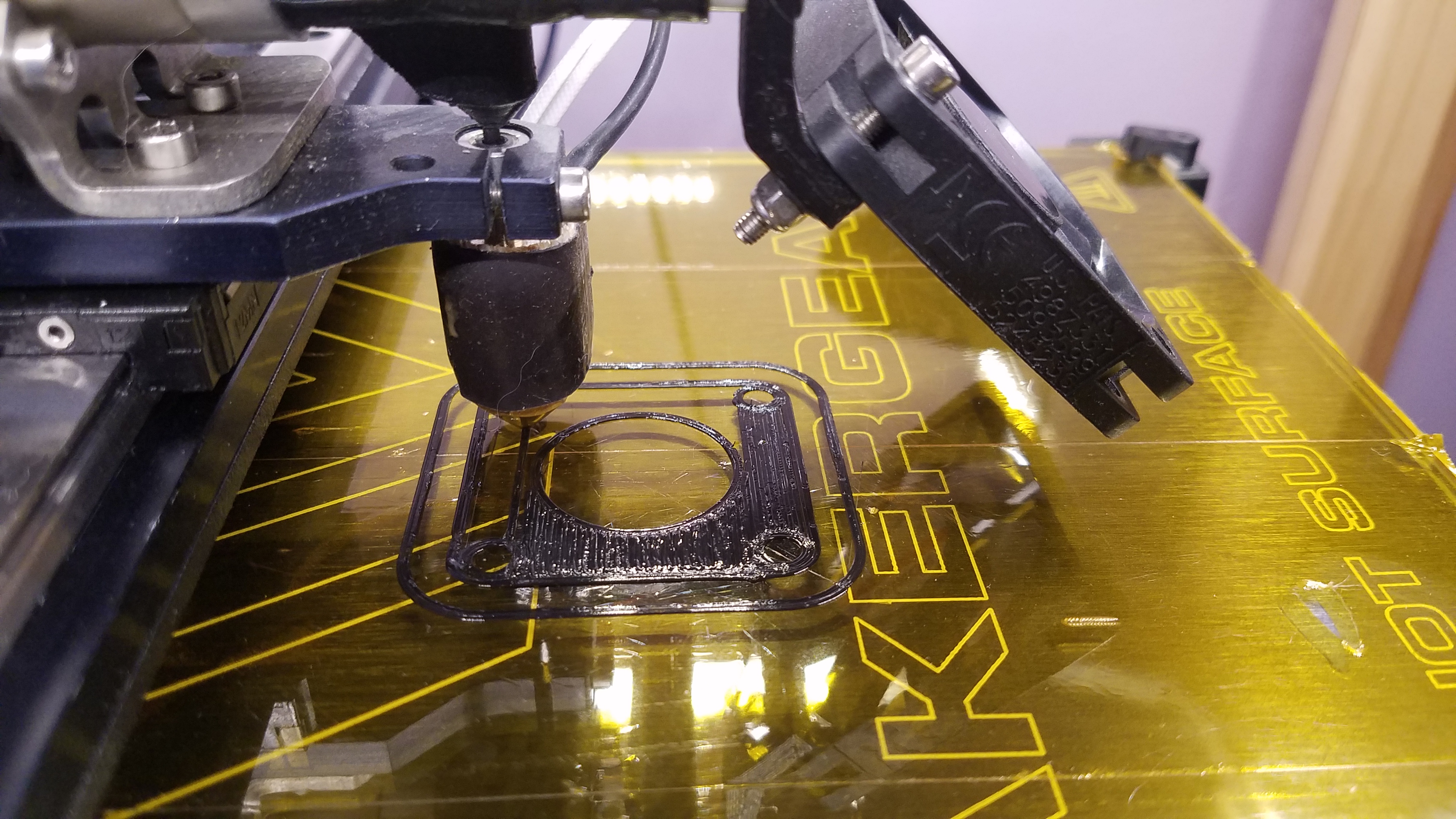

Got the Ninjafles.
Managed to get it to print but not really well. I guess most of the issue is the filament drive. I have adjusted the tension to get the best flow and have the spool suspended over the printer for gravity assist. Print speed is 10mms, temp 230, no retraction, .5 nozzle .2mm layer height..
Still get missed sport and rough finish.
The parts I am printing will work as is (Nema 17 Dampers) but I would like to get this working a bit more consistently if anyone has any other tweaks.. S3D is the slicer.

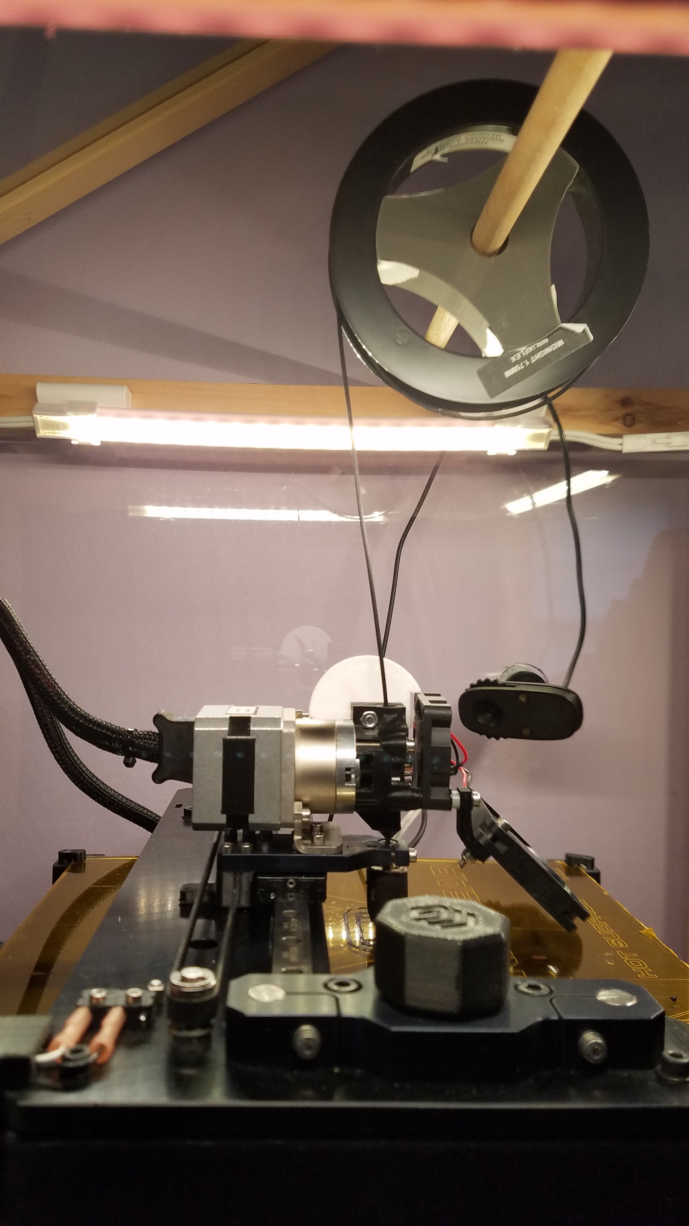

Printing flexibles requires a little bit of a different setup.
You are going to want to switch to a .50 nozzle.
Suspend the filament above the printer and "Gravity feed"
Slow down to about 600 mm/min.

6mmS .. Ok, had it running at 8 and it seemed to work better a bit faster. Just finished a spool center for the little slash spool to put it on a dowel above the printer..
Also, the NinjaFlex dampers work fairly well, not as good as a real damper for noise, but a good amount of noise reduction "without" the shaft issues of the other dampers. I only made the damper or Gasket is a better term 1mm thick.. Longer screws are needed to go thicker.
Thanks for the input going to do some more testing tonight.
Is this about as good as it get?
This good for Gravity feed?

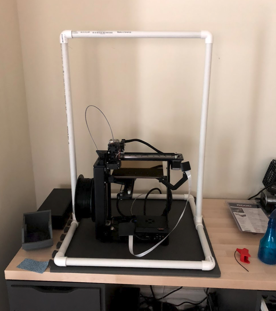

@airscapes - what is the height from the bottom of the pool to the extruder with your setup? I'm building pvc gravity holder for my ninjfflex /tpu filament and trying to see how high up the pvc rods should be
thank you

Post by airscapes » Mon Oct 22, 2018 3:44 pm
It's about 10"

Post by makeal » Mon Oct 22, 2018 4:51 pm
This should do the trick :)
