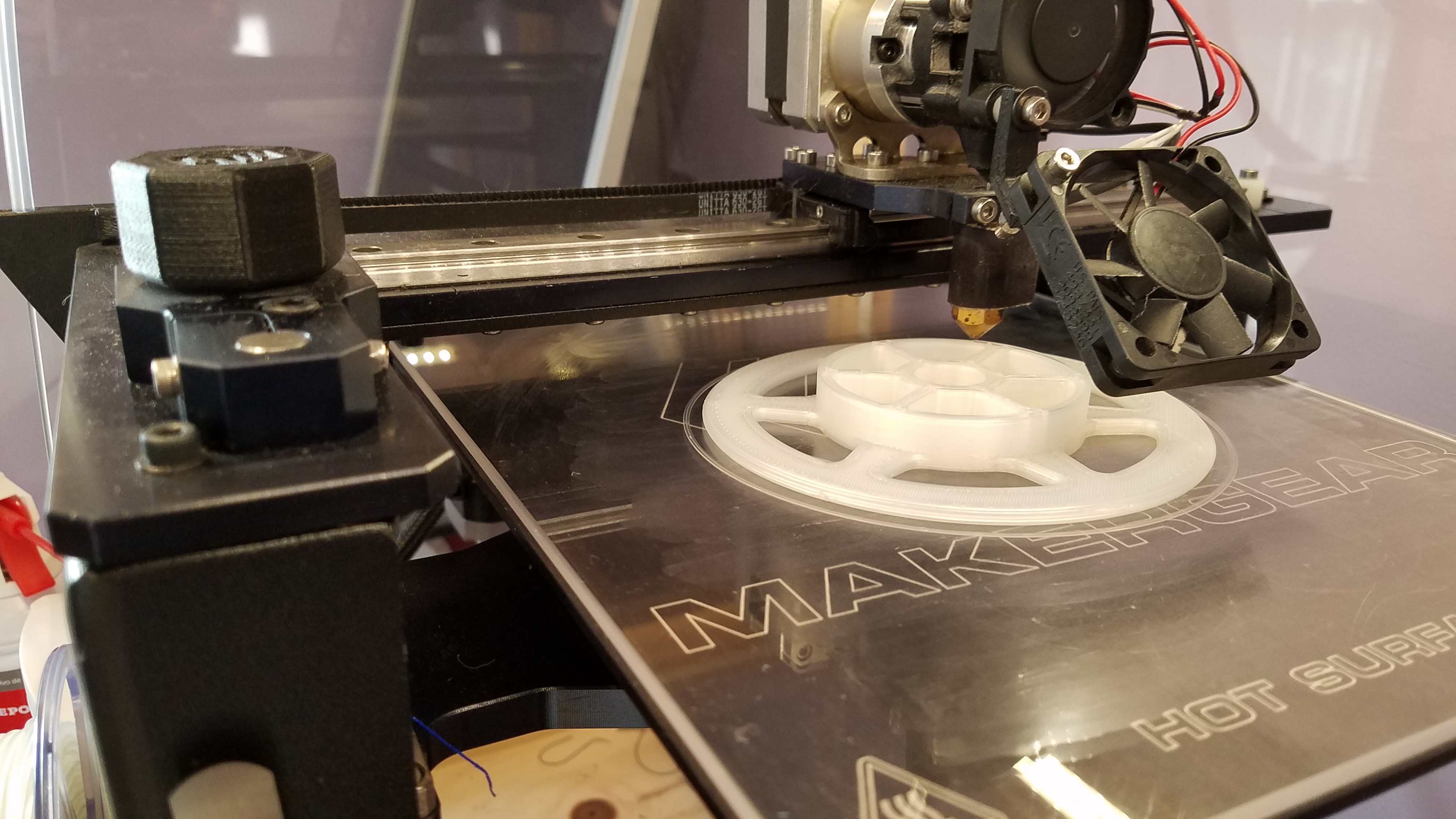

What speed are you printing? What layer height are you using and when and how did you last set your starting height? Hopefully it was an electric over as you can not dry filament in a gas fired oven as it creates moisture as the flame burns.. Bed temp should be 80C
See attached which is currently on the M2 printing, just have the glue stick on the plate as I have not had time to retape my second plate.
Once you get it all dialed in nylon is kind of nice to work with!

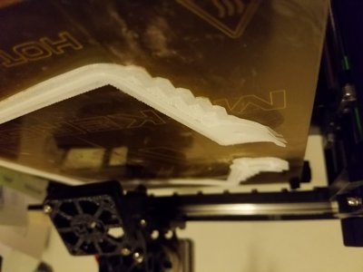

Yes electric stove and using Simplify 3D slow print rate but not sure of layer height its printing now and very slow rate. Not sure what setting I have but still trying. When I get some layers I will snap a picture, and send it. I did the 5 hours today in the oven but think I forgot to reset temp, now the spoil is wavy. Can I email direct, mine is turtlemanmaine@yahoo.com
