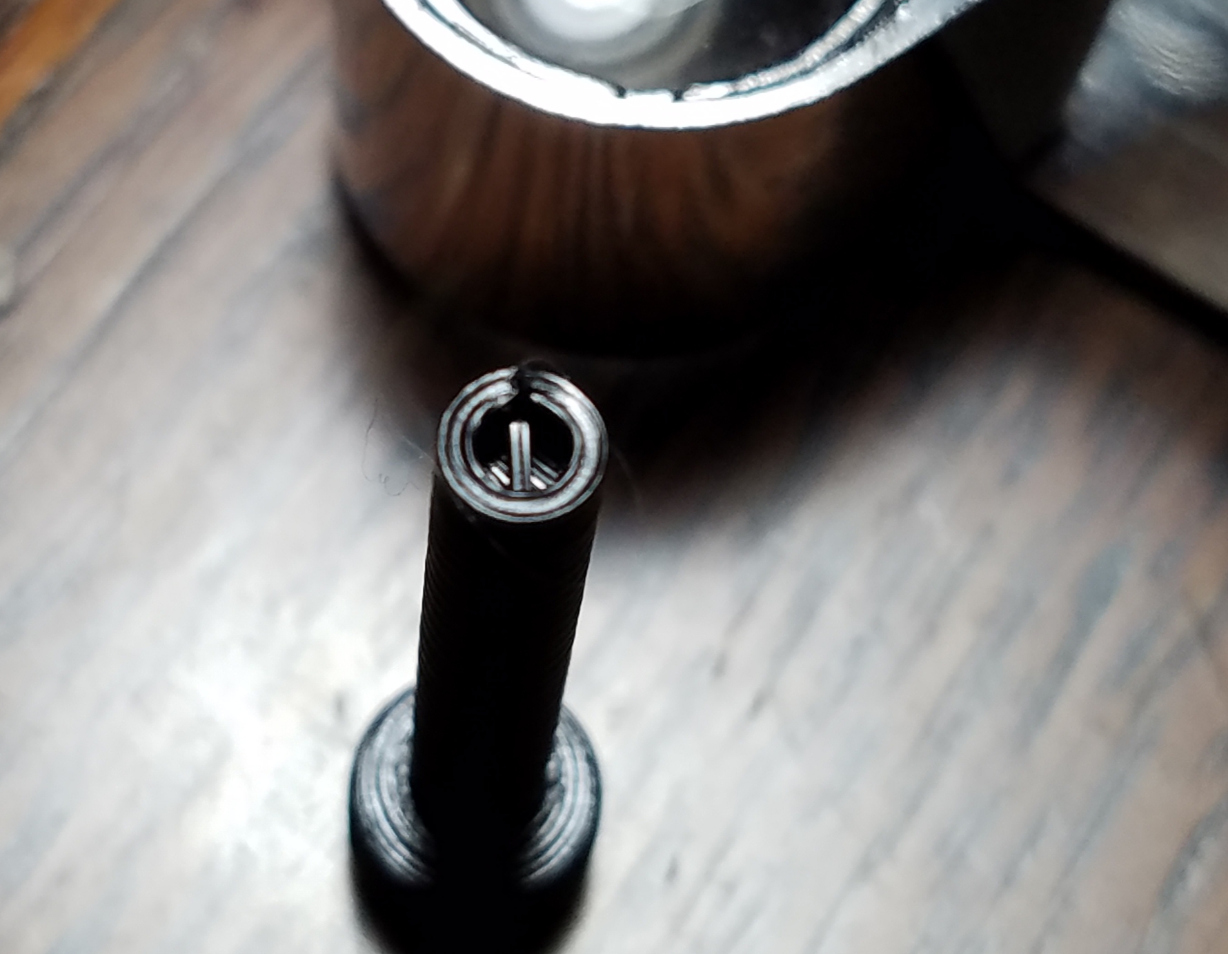

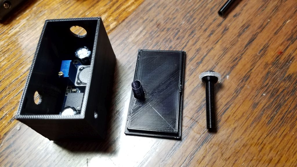

Yes, I printed a voltage adjuster for a Buck Regulator and was able to use .25 nozzle and create a tiny little screw diver and it is really holding up great.
I would guess most people just weak the extrusion multiplier.. but this guy ED I know.
Hi Ed! Taught me to enter the actually average diameter into the slicer which is used in the extrusion calculation. It actually works better then leaving it a 1.75 and adjusting the extrusion multiplier alone. I just got in the habit of checking and when I see something as thin as 1.62 I complain to the manufacture. I think the ability to print really small items without strings and with high strength is what like the best. I may have already posted this in this thread, forget what I did yesterday let alone last week but here is a picture of the adjuster for anyone who has not used 910 alloy
The box for the regulator and lid also made with 910 and the .25 nozzle

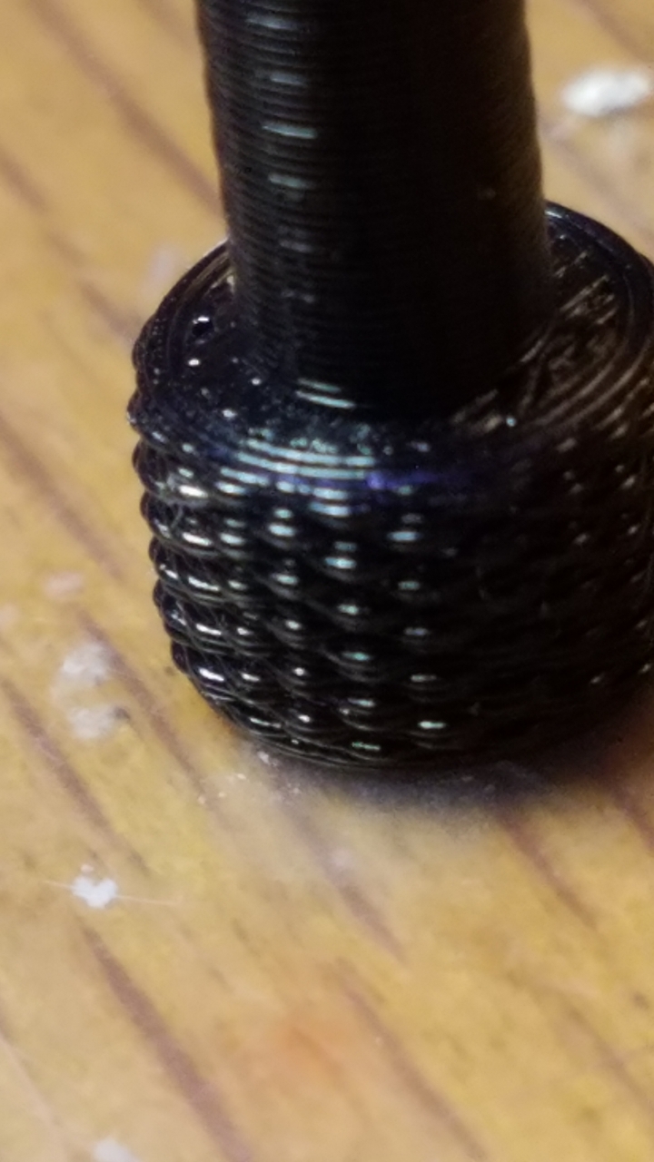

Found that the 910 is very slippery so added a knurl to the knob And the completed project
