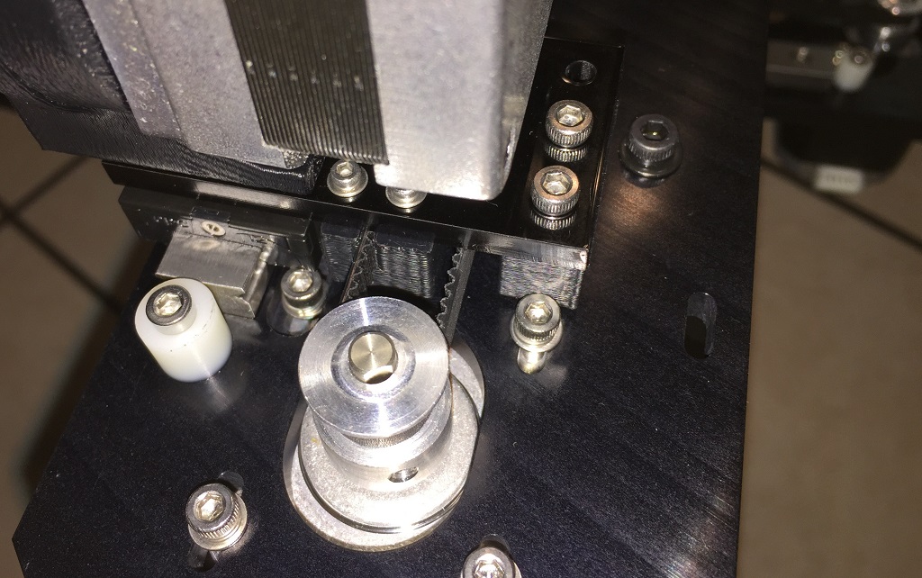

Lastly, what is the purpose of the nylon limit stop on the x-axis when this printed belt guide hits one of the motor mount screws first?
- nylon x limit stop.jpg (231.04 KiB) Viewed 49917 times

RE the nylon limit stop - good question
Perhaps its to just stop the carriage sliding off during shipping.

ben is right on all of them. the nylon bushing is just a safety thing. if you happen to have the motor off you NEVER want the carriage to come off the rail. do it once and youll regret it since usually the ball bearing will fall right out of those. you'll be chasing those all over the floor and good luck getting them back in.

R.U.,KiddingMe wrote: Lastly, what is the purpose of the nylon limit stop on the x-axis when this printed belt guide hits one of the motor mount screws first?
As others have noted, the nylon limit stop is there to keep the X carriage from sliding off the end of the rail for any reason -- as noted, you don't want the ball bearings falling out of the slide! But as I look at the picture, I'm wondering if you have the X-limit actuator block (printed part) mounted in the proper pair of holes. You have it mounted on the center and right holes. I seem to recall mounting in on the center and LEFT holes. How far does the carriage go to the left before it hits the limit switch? If the extruder is well past the edge of the glass to the left when the limit actuates, I would say the block is mounted on the wrong pair of holes.
With it mounted on the left and center holes, the carriage will hit the nylon stop right about at the same point the block hits the motor mounting screw -- which is how I think it's designed.

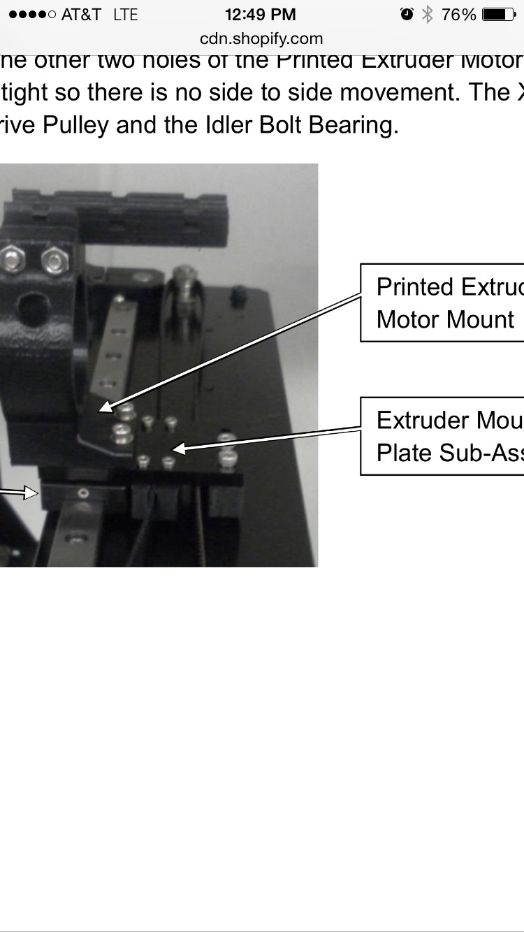

I thought that at first too but looking back at the assembly guide again it appears I have it correct.
- (123.09 KiB) Downloaded 602 times
