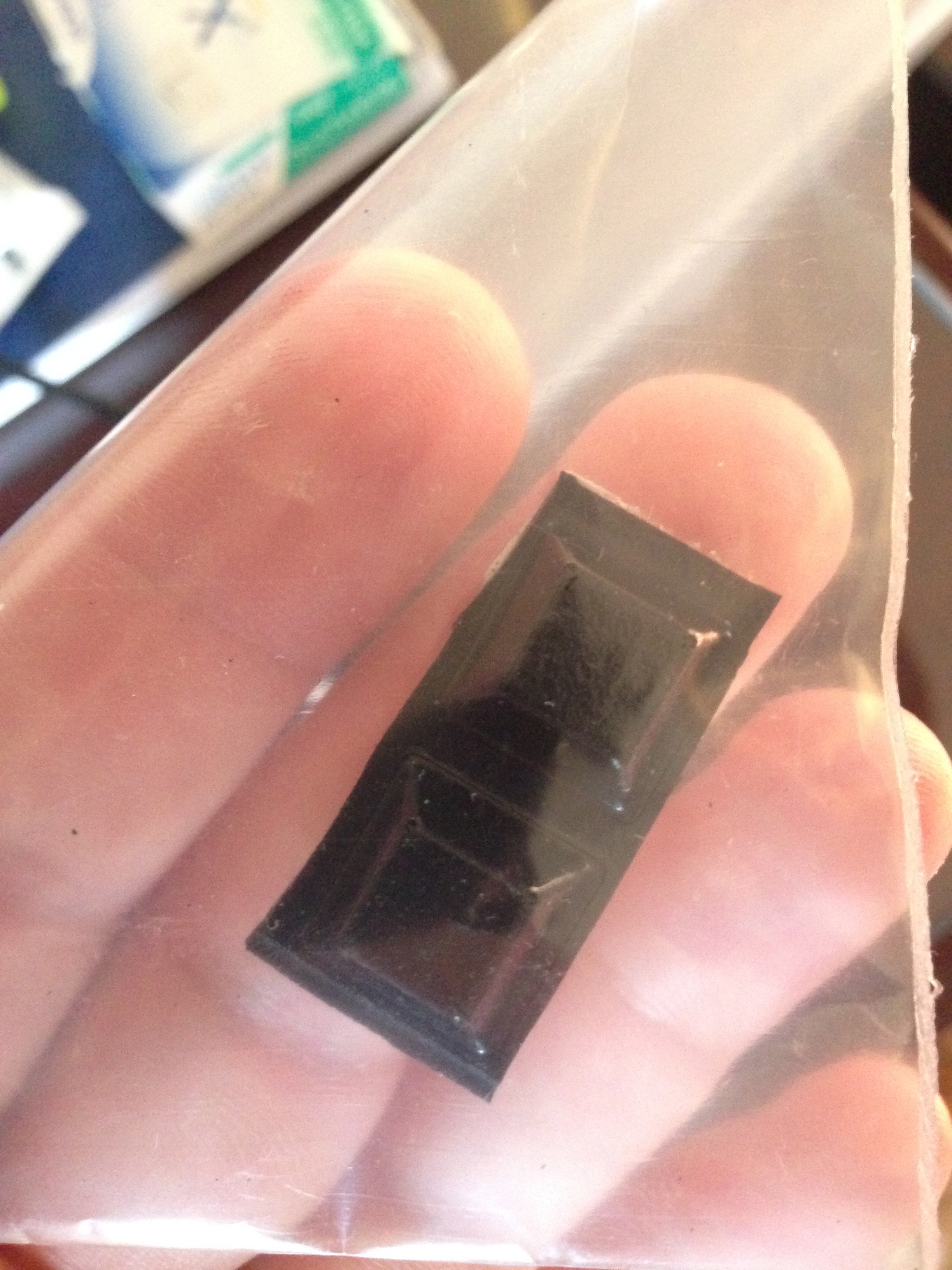

I also did not use the hot end/fans mounting blocks rubber feet, as I did not see this in the instructions. Should I use them?

jeffpowell101 wrote:I also did not use the hot end/fans mounting blocks rubber feet, as I did not see this in the instructions. Should I use them?
The big rubber feet (screw-mount) may be "packed with" the hot end and fans, but they are not "FOR" the hot end. They mount on the bottom of the frame. There is also one small rubber foot (stick-on) that mounts under the rail under the left front -- it's there to help prevent tipping in that direction, because the big rubber foot has to be set so far in from the corner.
If that doesn't help you, perhaps you could attach a small picture of the part(s) in question -- then we'll all go: "OHHHHH! THAT'S what you meant!!!" ;-)

Thanks for the help. I've attached a picture of the parts I'm talking about.
