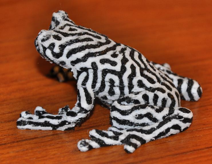

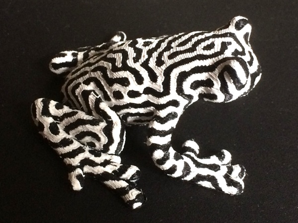

Another dual extrusion test print.
Cura with wipe tower, ooze shield, and brim. I think the brim may be mandatory or else the wipe tower/ooze shield get knocked loose at some point.

Nice frog. I also had to use the brim to keep the tower from getting knocked over. The only problem was it was harder to see that I was over extruding. It was evident after I trimmed off the shield.

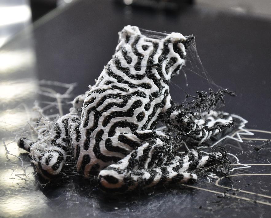

I decided to give the frog a go as my first dual-extruder print (other than the quick calibration test) and with no attempt at using an ooze shield or, for that matter, doing much tweaking of any kind. I just sliced it in S3D and ran with it. Pictures of the results are attached. I think it's not too bad, considering. A lot of oozing, quite a bit of stringing, poor quality on the unsupported severe overhang under the chin. You can see that the black fades out at the top, the result of needing extra extrusion after a retraction.
I also found one bad thing to avoid. The MakerGear wiki said that the factory files for the Dual Julia Vase (I used the right and left processes for this slicing) are without temperature settings. I think this is not true. However, to be certain, I manually set the temperature in S3D. Bad, bad, bad. That causes S3D to issue a tool change in the middle of the communications which gets inserted randomly into the beginning of the print. So at the beginning of layer number 2, the tools got switched. The black filament, which was not retracted, got extruded into a big blob, and then the entire layer got printed in black. So, lesson learned: Don't do anything manually that will send a tool change command. Fortunately, the blob of filament got flattened out on the next pass and the print recovered nicely.
The frog is really a nice torture test for the dual extruder. It's basically a worst-case scenario of a two-color model.

- Frog on the glass plate immediately after printing
- frog_on_bed.jpg (168.86 KiB) Viewed 28301 times
- Frog cleaned up a bit
- frog_cleaned.jpg (130.44 KiB) Viewed 28301 times

The S3D dual extrusion support is really not quite ready for prime time. As I reported in the other thread, the tool change sequences it puts in are... unexpected. I had to go in manually and fix them up. It may be suitable if you just post-processed the geode to detect T0 and T1 and insert your own tool change sequences.
I think I went up to 10mm retraction, but it continued to ooze. I haven't gone up to 16mm, which is the Cura default, you may wish to try that. Maybe retract as far as it will go without falling out and see if you still get ooze problems.
The Cura wipe tower serves to prime the incoming extruder, so you don't have to worry about that as much. The ooze tower deals with the outgoing extruder continuing to ooze. Overall, the Cura dual extrusion support is vastly superior, although if you do use an ooze shield your entire model gets encased in a shell which you have to remove. Remember to use a brim either way, as they have a tendency to separate from the bed.
