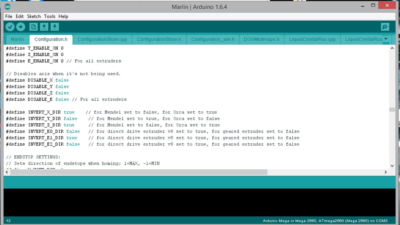

Look at the True/False settings in the attached pic under the config.h file to set the extrude direction (someone had a question about this). Due to the drive gear being placed on the opposite side, the extruder also has to run in the opposite direction.
Regards,
-Don
