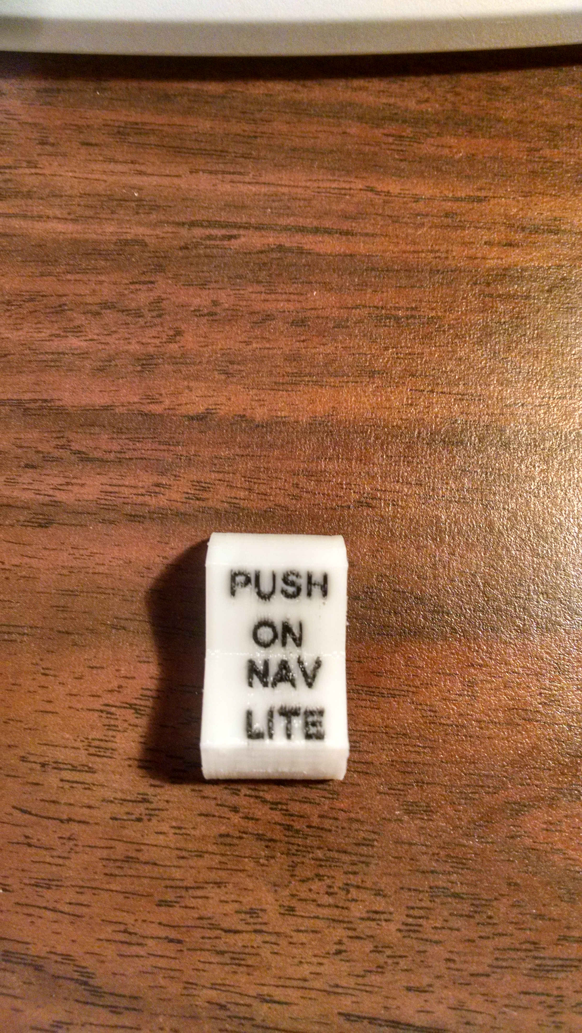

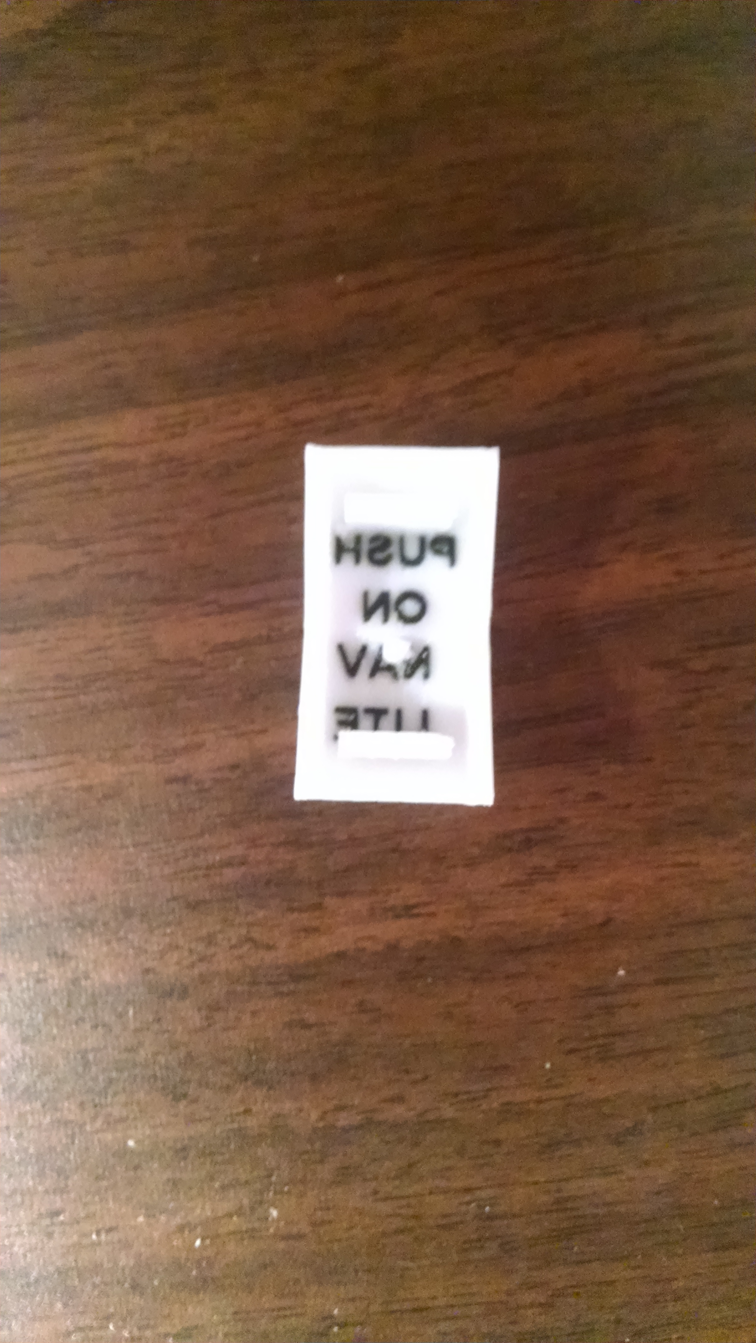

Here is another try. The switch cover is shelled to be 0.065" thick, so I made the black lettering the entire thickness. I also increased the size of the font, and I know, the NAV LITE needs to be centered. See what you think. (I find the back might look a little better than the front.)

zemlin
Posts: 467
Re: Can support increase accuracy/definition of small featur
Post by zemlin » Mon Mar 27, 2017 3:27 pm
If the back looks better ... is that related to where the printer starts the outlines? What happens if you flip the part 180 degrees on the bed?
Phil
Posts: 214
Post by Phil » Mon Mar 27, 2017 5:09 pm
zemlin wrote:If the back looks better ... is that related to where the printer starts the outlines? What happens if you flip the part 180 degrees on the bed?
Great question! I think I will try again with 0.25mm nozzles, and maybe make four, each rotated 90 degrees from the last.
