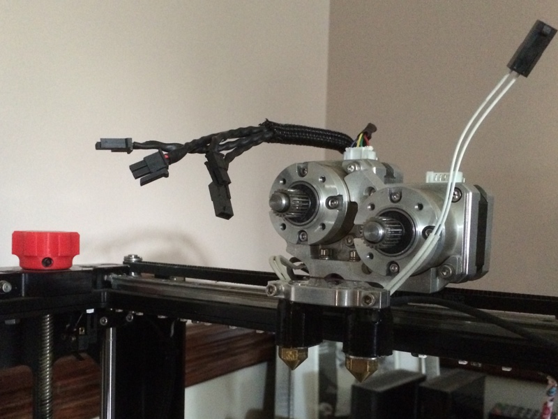

Just getting started on my upgrade, haven't started the wiring harness work yet. But here's a picture.

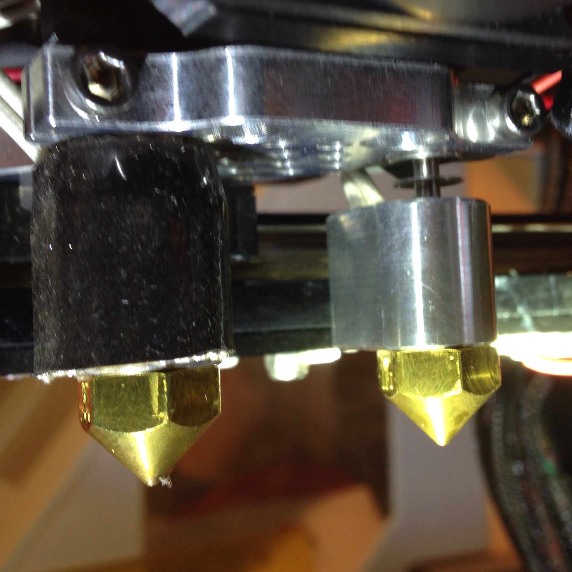

Post by jimc » Wed Aug 06, 2014 1:41 am
looking at your pic jin, whats the deal with the heaters? its hard to see but the hot ends dont appear to have the traditional block style ones. are they the regular heater cartridges and what are they mounted in to transfer the heat?

jimc, they are short block heaters under the insulation, oriented vertically. I'd take a picture for you, but my cable is out and my phone needs to be docked for me to be on the internet. It is downright primitive, and Comcast is causing me to revert to a Hobbesian state of nature.

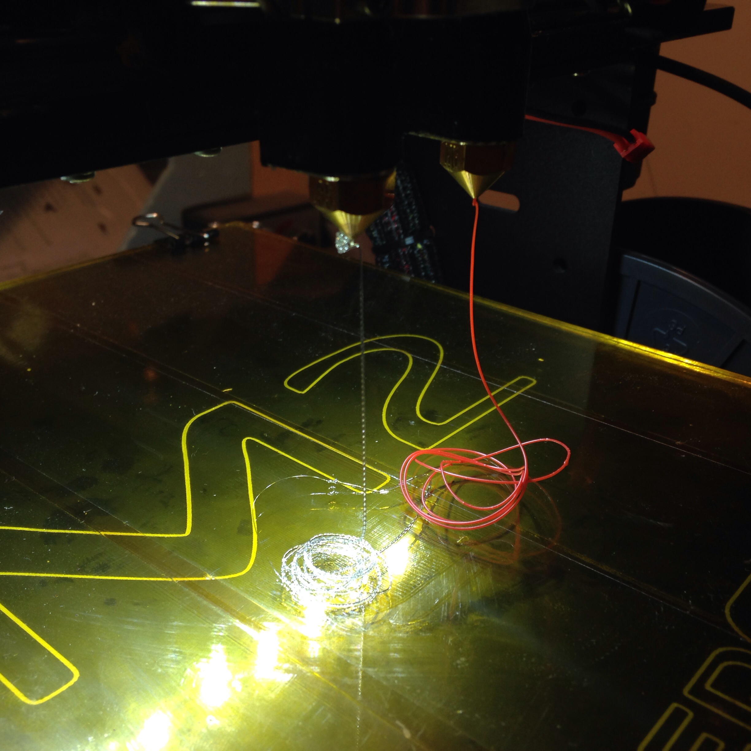

Rocketdog
Posts: 26
Joined: Fri May 02, 2014 7:33 pm
Re: Dual Extruder Upgrade - Limited Availability
Post by Rocketdog » Wed Aug 06, 2014 4:18 am
Here it is
