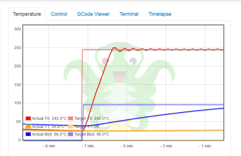

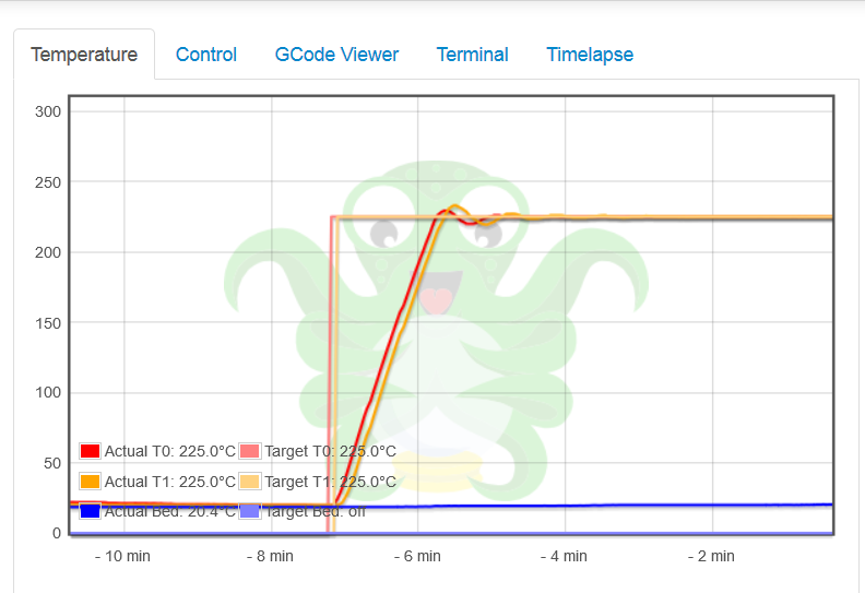

Post by sprior » Sat Aug 09, 2014 11:31 pm
So far I'm using the same temps I used with V3B and haven't noticed any problems though I was no expert in judging such things.
I did notice temperature ringing with the stock dual firmware:
Temperature ringing with stock dual firmware.
So I ran PID autotune and then updated the firmware with the new values and think it has improved:
less ringing
Dale Reed
Posts: 376
Re: Dual Extruder Upgrade - Limited Availability
Post by Dale Reed » Sun Aug 10, 2014 1:44 am
sprior,
Looks like textbook quarter-amplitude damping. (Ref: Coughanour & Koppel, senior year Chem E. control theory class...) That minimizes the integrated error (net area between the curve --- above minus below --- between actual and setpoint), but allows some overshoot and ringing. You could reduce the "P" value to about 2/3 to 1/2 of its current (autotuned) value and see how it looks. It's a slightly slower approach to setpoint, but it should resemble critical damping and approach with just a tad of overshoot and little ringing. If you cut the P value to about 1/3 to 1/4 of its current value, you'll be closer to lambda tuning, which should eliminate overshoot, take a bit longer to get to setpoint, and eliminate ringing altogether. But it's a bit slower to react to changing between extruding and not extruding (heat load changes).
I'd suggest setting P to 1/2 the current value and see if you like it. (You can always set it back if you don't!)
Dale
