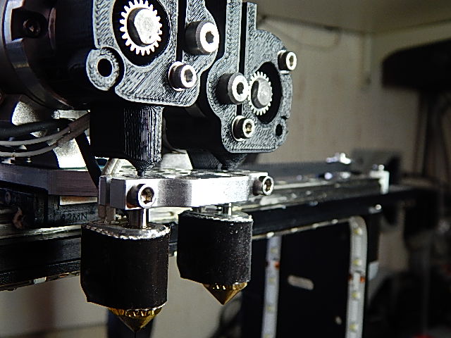

I really hope Rick doesn't mind my posting this photo. But if the dual V4 kits are available, I guess folks should know what it's about. Here's a photo with the fans removed:
V4-dual with fan assembly removed
Note how the two (tiny!) hot ends are mounted with the clamp to the bottom plate. The bottom plate extends straight back and mounts on the X-carriage slide bearing. The vertical plate holding the two extruder steppers mounts to the bottom plate, about halfway back from the hot ends to the carriage. Note how the steppers are offset vertically so the hot ends can be closer together, maximizing the area of the build plate that both nozzles can reach.
In my setup, the PFTE lined hot end is on the left, the all-metal is on the right.
Not sure if it's clear in the photo, but there's about a 1.5 mm gap between the bottom of each filament drive and the top of the hot end barrel. The one in the left on the photo is threaded with black PLA, and the one on the right is not threaded.
Hope this helps you see how the filament drive only touches the stepper motor face and doesn't (directly) touch the plate with the hot ends mounted.
The fan assembly is ducted so that the extruder fan blows on the drive gears and down on the plate, between the hot ends, to keep them from pushing too much heat toward the steppers.
Get the idea?

The new dual kits, are they one PTFE one all-metal like the betas? Lot of my printing is in nylon and PC, I'd like to keep the ability to push 260 and beyond comfortably before committing to the purchase. Also, looks like nozzle changes would be... discouraged on the hot ends, is the recommendation just to buy several nozzles with different diameters?

I'm pretty sure they're defaulting to 1 PTFE, 1 all-metal. I use the all-metal with everything except PLA, PVA and Ninjaflex. It works great with ABS and Nylon :)
The V4 is actually the easiest nozzle change I've ever done on any hotend I've ever owned -- even easier than the Budaschnozzle. I love it.

It will be two PTFE v4s. We've run a lot of PC at 290C pretty much without issue.
Officially, we will not suggest going above 260C with the ptfe v4 but you are free to experiment.
