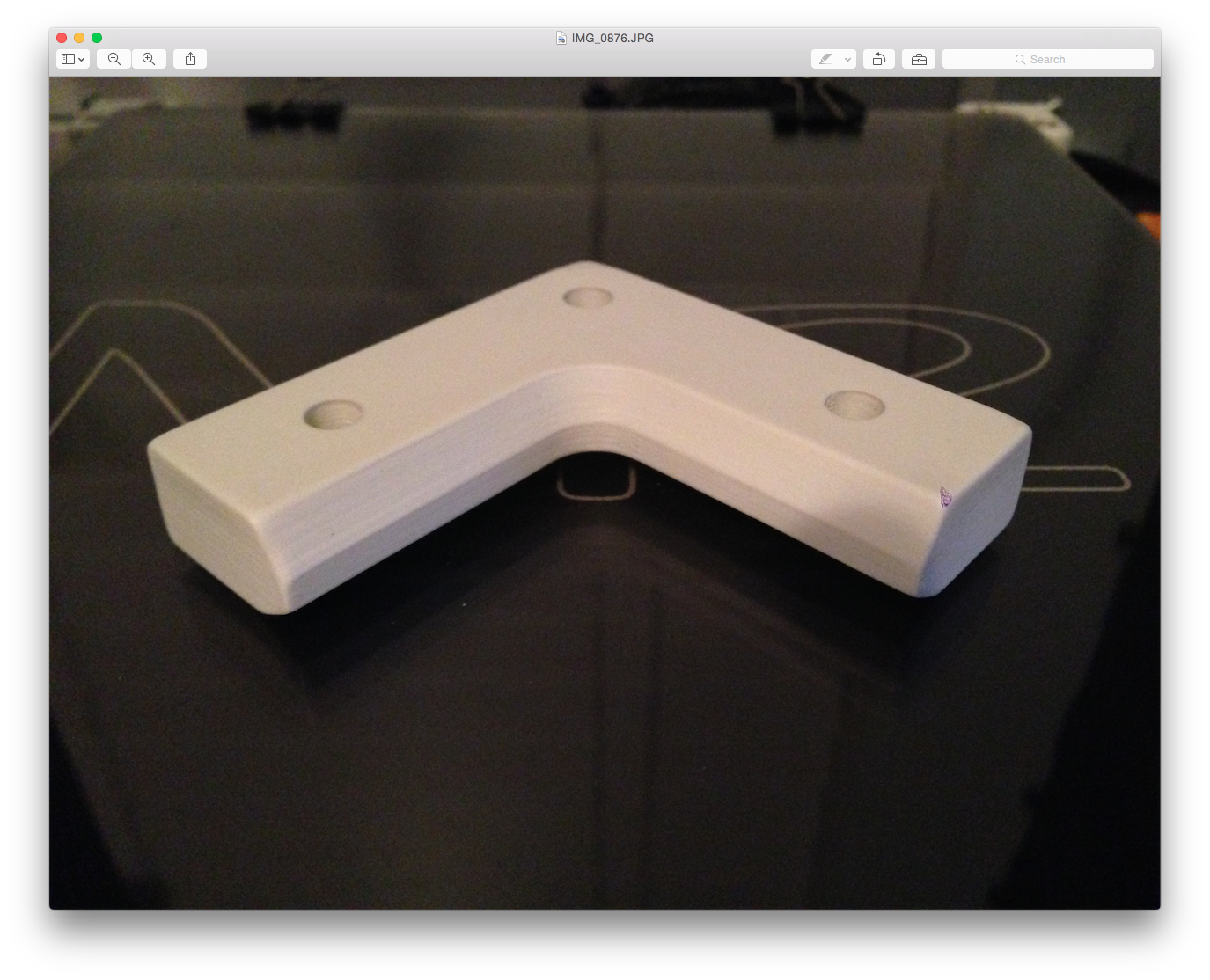

V4 up and running. Ran some ABS part turned out looking good.
(1.87 MiB) Downloaded 275 times
ready to resume printing.

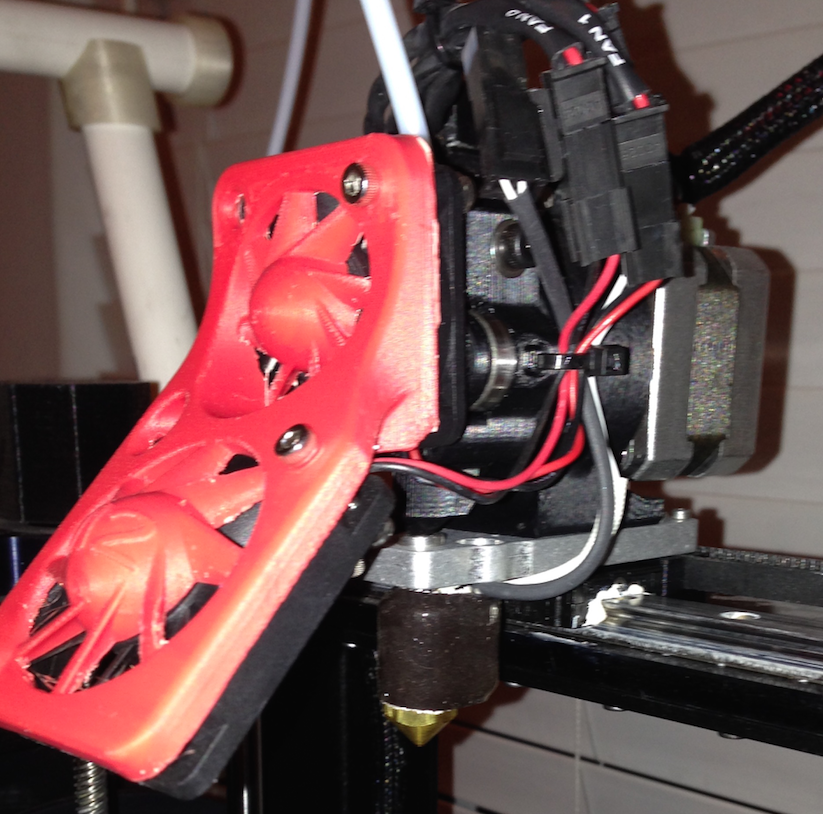

Here it is installed, very straight forward.

That part looks awesome! So would you suggest to move from V3B to V4? Is print quality better? I'm thinking about it

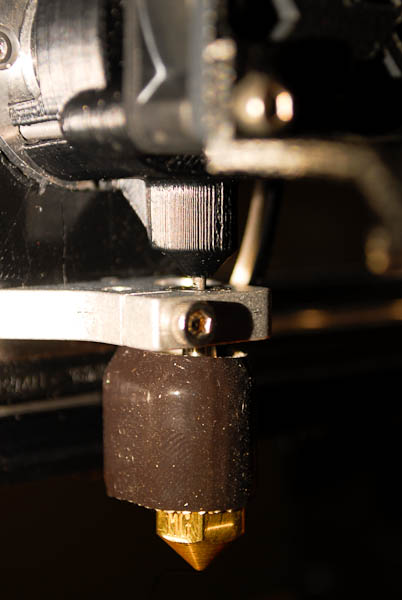

Ronnien55, it looks good and it might just be deceiving in the picture you posted but you don't want your actual hot end to touch the conical (cone shape) part of your extruder drive. There should be a bit of a separation between the two parts like shown below. If yours is touching just loosen the screw and drop it down a bit. (make sure its off though :D )
