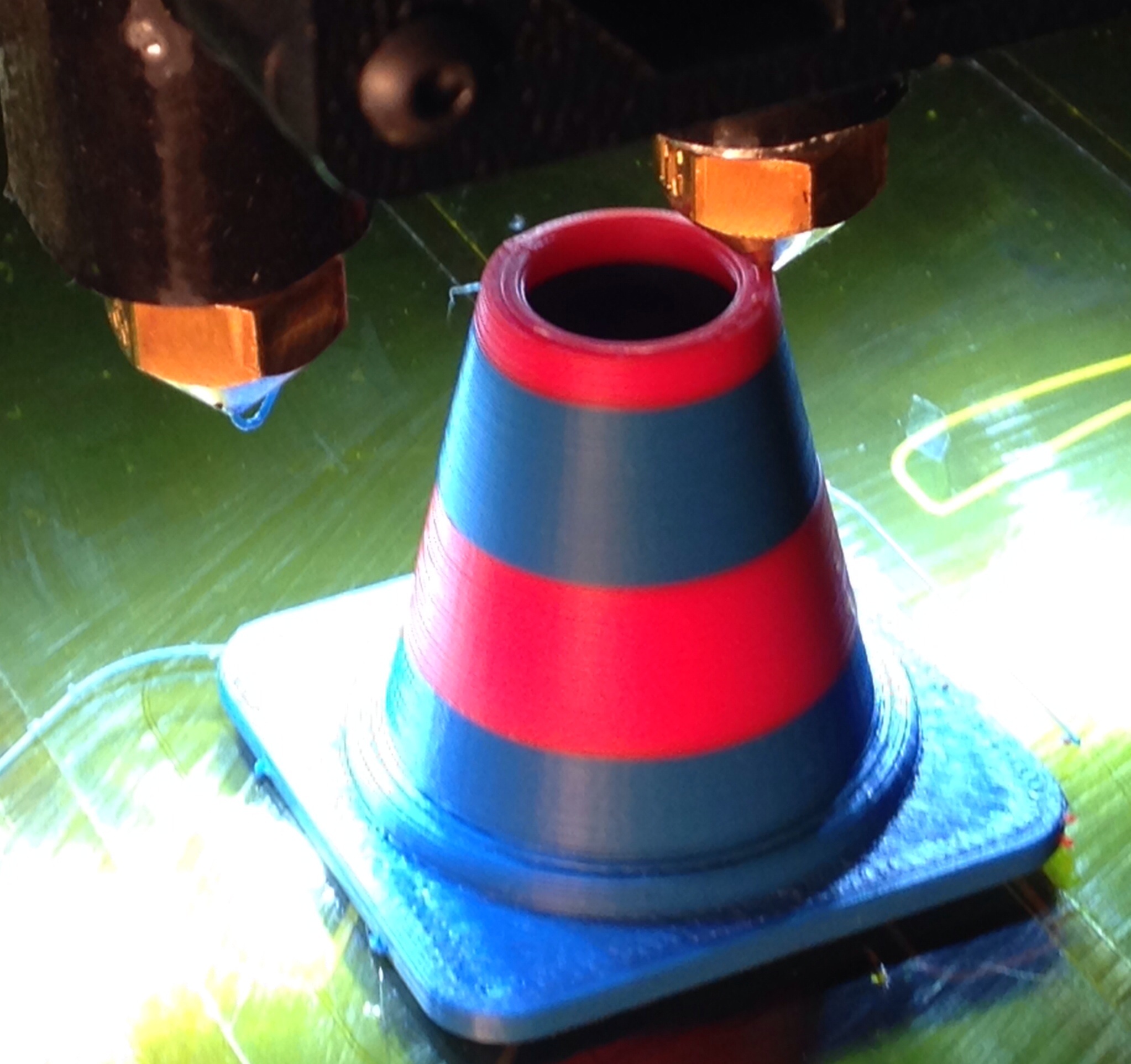

I see Capt. John's first question doesn't seem to be answered in the replies above. Didn't want to leave it hanging...
The 2nd spool holder mounts outboard on the right-hand side of the frame, very much like the existing one on the left. The dual-extruder kit includes the spool holder, the guide tube, the second filament guide bracket, second extruder motor, wiring harness, etc., etc. Josh had a dual machine printing while I was there, and it looks sweet in action. Based on what I saw, I went through the contents of the box mentally (as best I can, considering... ) when I got it home, and I couldn't think of anything that might be needed to upgrade the M2 to dual extruders that was missing from the kit.... including the requisite piece of candy.
Can't wait to get it set up and test it out!
And thanks to Josh for letting me, once again, take his afternoon off on some interesting tangents! Seriously, in addition to building M2s, it's like a Josh-idea-factory in there!
