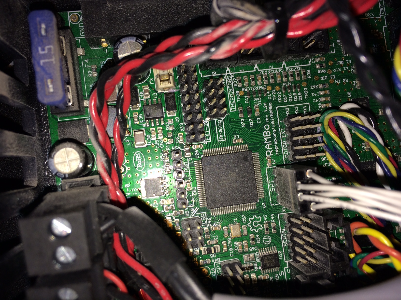

Tim, it's more confusing than that - the stepper motor drivers don't receive serial commands from the Atmega2560, they just received high/low signals. It's a combination of high/low signals that sets the microstepping mode (the same thing can be done with jumpers, as on the RAMPS board with Pololu stepper motor driver breakout boards, for the same stepper motor driver chip). The confusing thing is that, electrically, the signal for x8 or x16 microstepping is the same - all HIGH, IIRC. The difference is just that one specific chip part number uses that as x8, and the other as x16 (the latter does not have a x8 microstepping mode because of this).
Q*bert and brett - what specific RAMBo revisions do you two have? And did you change the firmware at all before uploading (the steps/mm for instance)? And/or, have you changed anything in EEPROM on your old firmware?
brettb
Posts: 13
Joined: Sat Jun 21, 2014 7:45 pm
Re: Help!!!! Dual extruder problem
Post by brettb » Tue Aug 12, 2014 9:04 pm
I have the Rambo 1.2d, this was the same board that had the issue with static electricity when running off of a laptop.
Rambo1.2d
(917.42 KiB) Downloaded 1448 times
