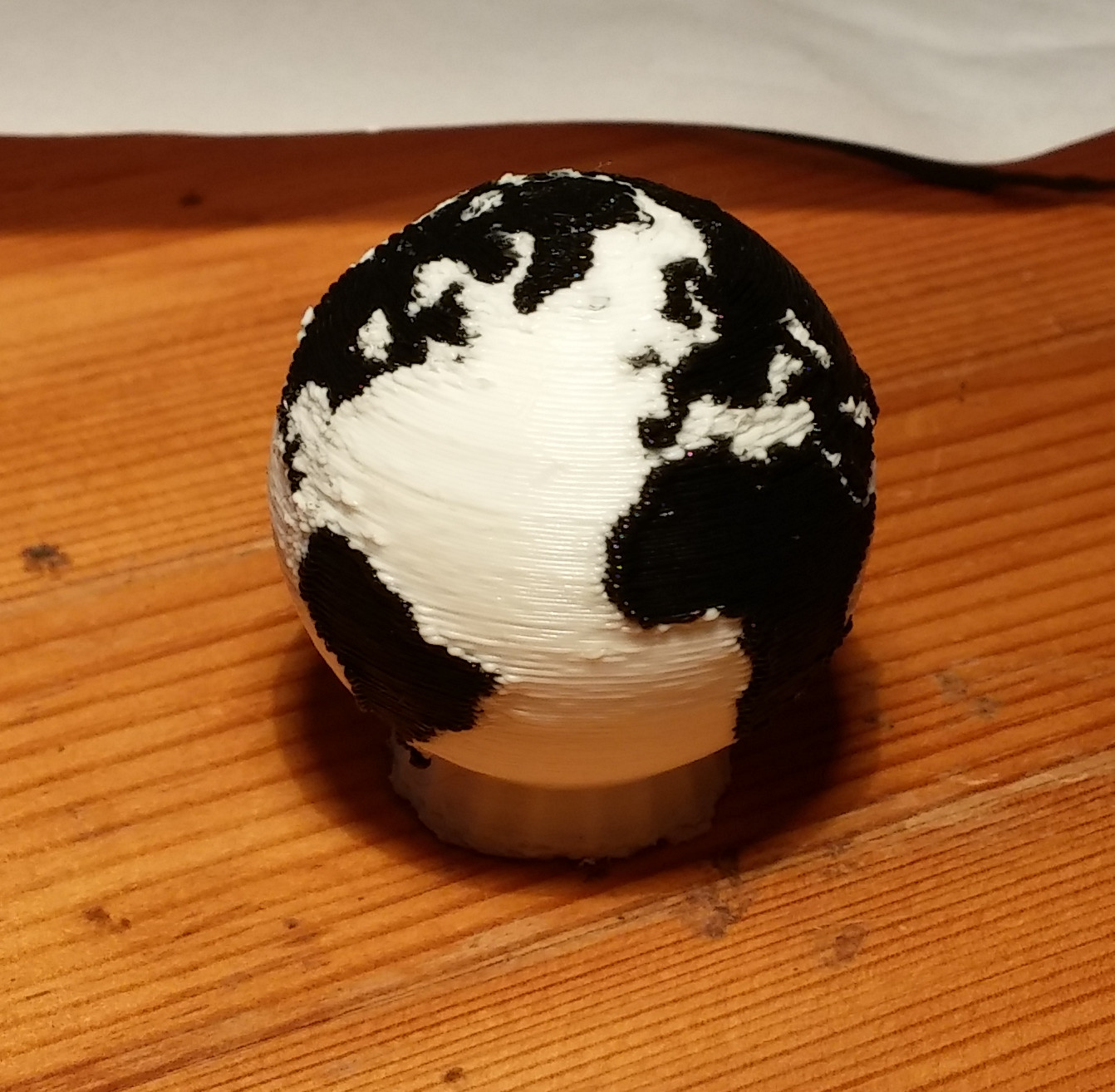

I've made a couple of attempts at printing http://www.thingiverse.com/thing:28202 but with no success so far - the right (metal only) extruder keeps clogging. Of course I'm not sure WHY this is happening, I'm printing with PLA in both extruders and swapped the colors to make sure it wasn't the plastic. With the V3B hotend I was using the 225C temp from the rsilvers profiles, but tried 215C since the wiki page recommended it. Then I upped it to 220C and also got a clog.
I see a bunch of possibilities here. I'm noticing that it's the all metal hot end that's clogging and that the right extruder is spending more time idle.
Has anyone seen anything like this?
<edit> forgot to mention that I'm printing it at half size - I cared more for the process than the end result.

I had the same issue with pla and the fist few layers. I think that the tip was moving over some drool and getting plugged from the blobs on the glass. I haven't seen this with ABS on the right side.

If it's the toolpaths, then it may be wiping the same drool in the same spot on the same side every time. You might see a difference if you rotate the model, or try a model like the tree frog with more change in the toolpaths from layer to layer.
I think, though, that we all just have to get used to using Cura and generating wipe towers and ooze shields. I got a late start on the dual extruder assembly and am not quite at that point, though. There's a lot of experimentation to be done by everybody. . .

I'm trying again with ABS tonight - so far no clogs and noticeably less drooling. I'd really rather not rule out PLA for dual color prints though.

... so this time, with the 'seasoned' extruder, I didn't encounter a clog with PLA on both sides
for this print (http://www.thingiverse.com/thing:11660 half size):
