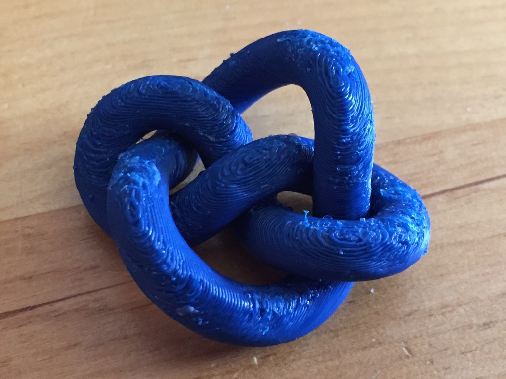

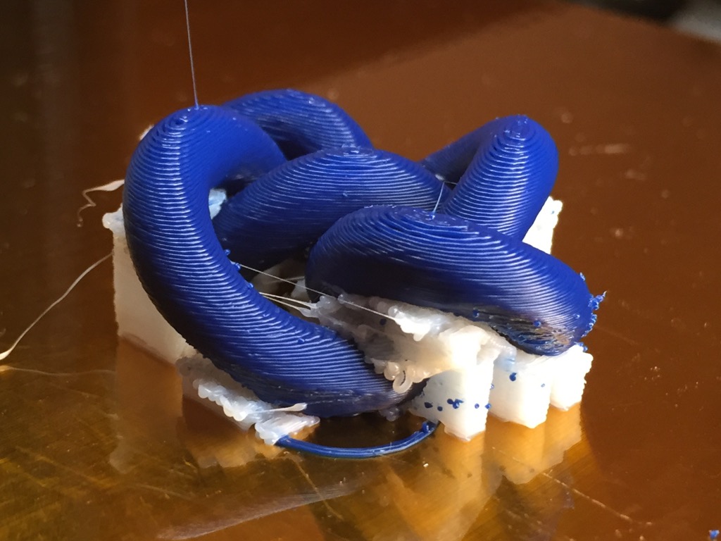

HIPS can be had cheaply now, so I decided to try dissolvable support. I used my whitehead link for the model. I used 80% interface layers with 0 layer separation and 0mm horizontal separation with Simplify3D.
As it came off the build plate:
Supported surface:
Good things:
  • Using the second extruder for support works well. You don't have to worry as much about oozing because the main filament ooze will mostly be caught by the support, and the support filament ooze will all be going away anyway.
  • HIPS dissolves away very well in limonene. There is some visible residue in my photo, but it is soft and easily wiped away.
  • ABS sticks well to HIPS. Will try PLA on a HIPS raft later.
  • Having a solid support with no separation makes precarious objects easy to print (and "impossible" prints possible).
  • You can have support in places where it would be very difficult to remove.
Not so good thing:
Bottom surface quality didn't turn out as well as I'd hoped for. Actually, some of the imperfections are from overhang curling in unsupported areas. The fully supported areas turned out okay. I will try a print with much more extensive support later.

So how do you compare this to the one that you posted in your original thread on "OpenSCAD knots"? That one looked impressively defect-free. But then, judging from the concentric rings directly facing the viewer, I'd say you photographed it from the good side. For fairness, you have to show us the bad side of that one!

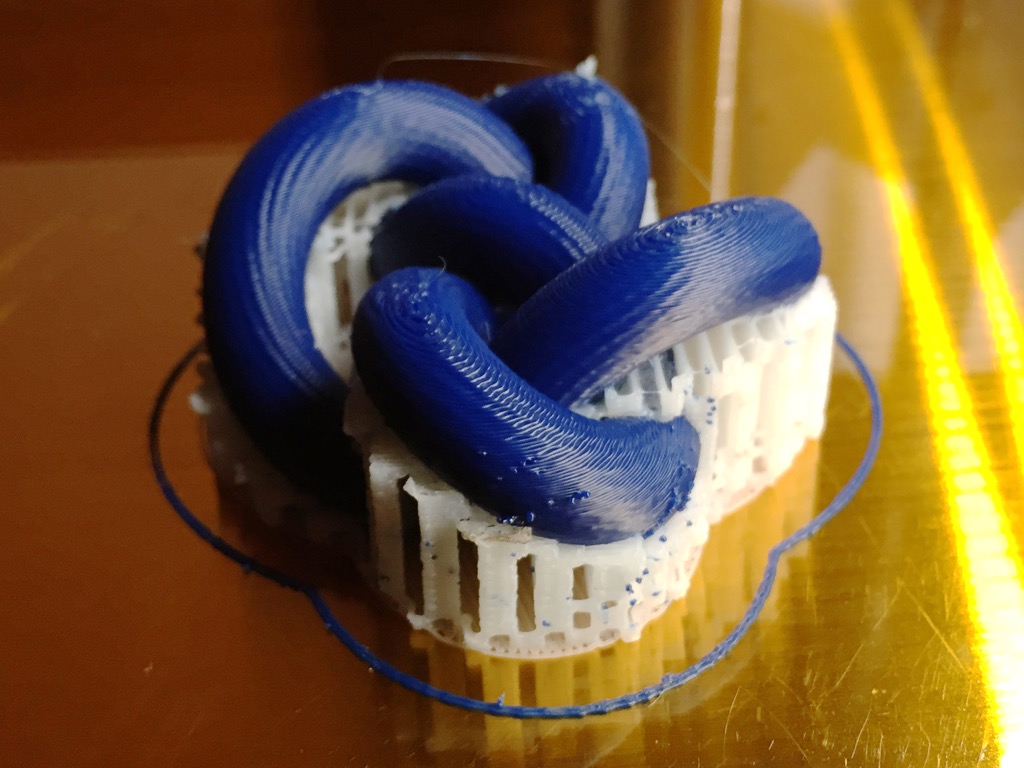

jimc, you can see in the top picture how the support was fairly restricted, about 55 degrees and up I think. I've just finished another one, a little larger and with more aggressive support settings. Looks good for now, but we'll see the result when it comes out of the drink.
Tim, I gave the white one away to my friend getting his PhD, so I can't show you the underside. As you suspect, the bottom wasn't nearly as clean.
