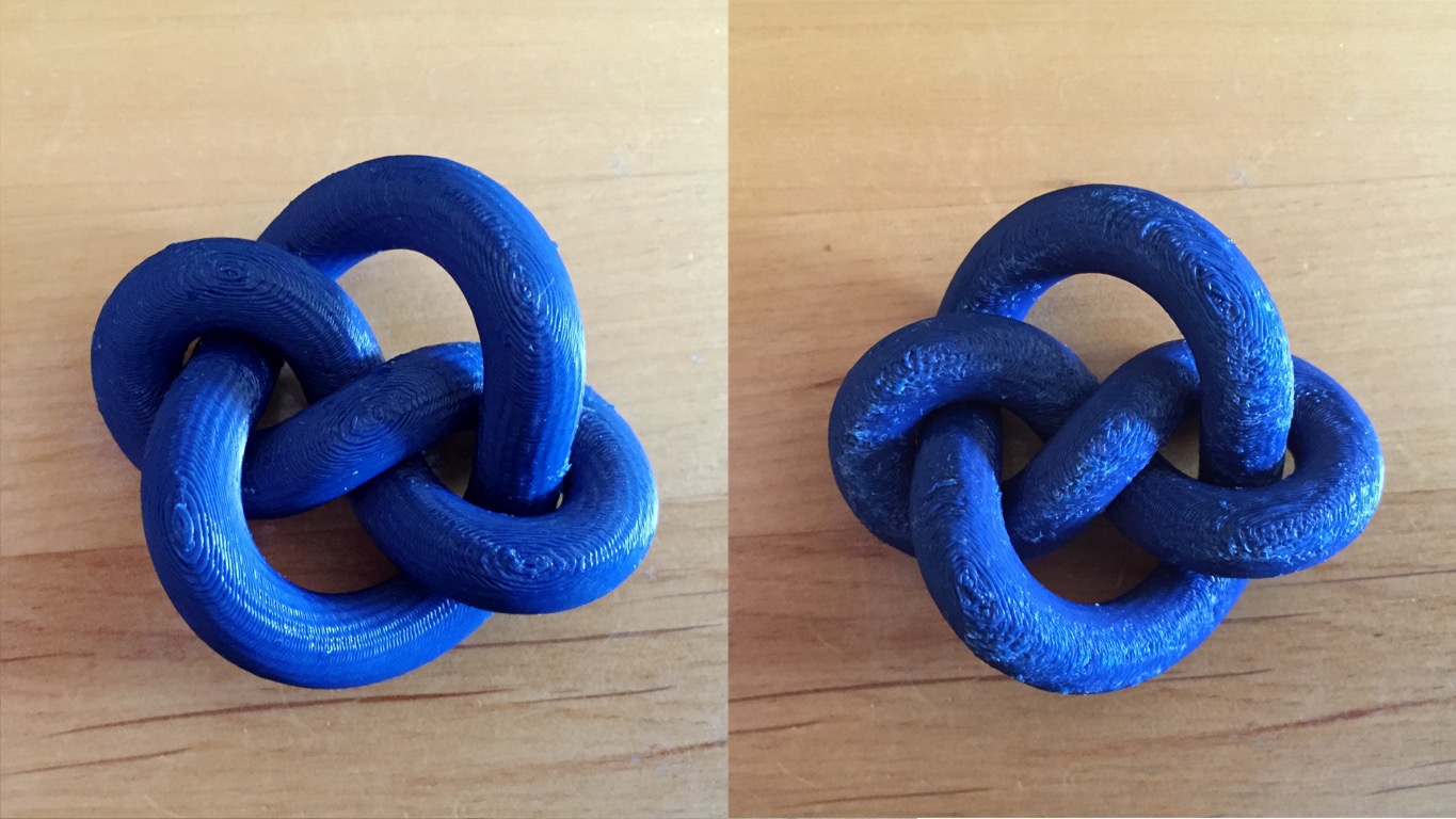

Here's the result of the latest print. Not much improvement on bottom surface quality. I guess the print itself was easier to accomplish than when I did it without the dual extruders, though. The model has some serious overhangs and requires support in hard-to-remove areas. With zero separation, there are no overhang issues, and you can put support anywhere you want.
