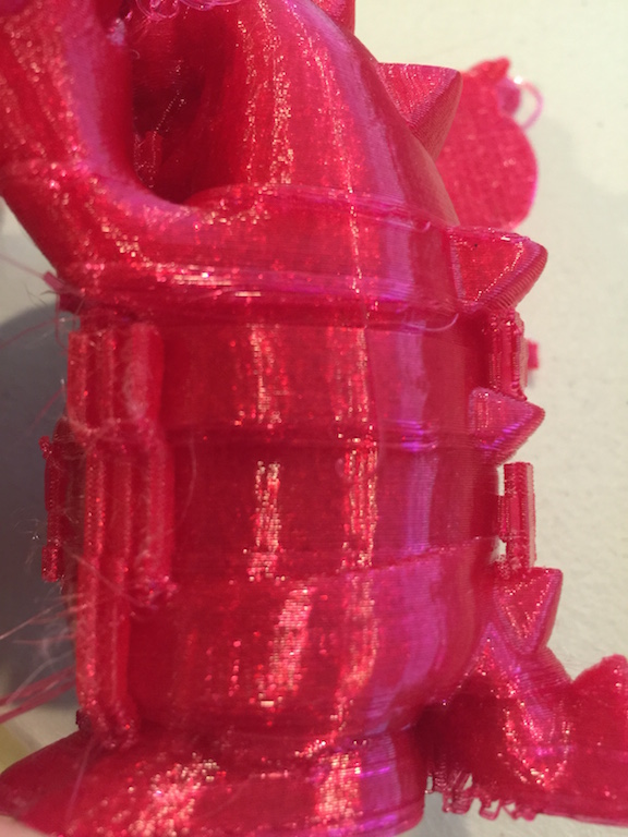

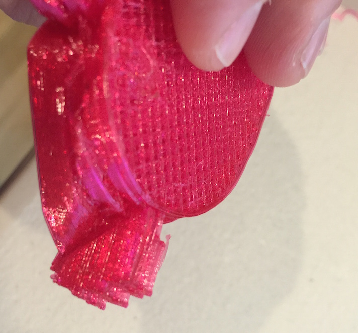

Ever since upgrading to the M2 Dual Extruder I have had a problem with shifting layers. I assume it is because at times I can hear the print make a loud noise and even visibly shake. I used to have the problem when I printed with a V3b .75 nozzle and a .6 layer. The nozzle would smack into the print when moving around the bed. This time I can't see that it strikes anything. All the axes move freely. The Z axis "sticks" a bit and won't naturally fall down. It does seem to move normally. I had a another Makergear M2 owner come over and "rehab" my machine so it was working smoothly. It did for many prints and then started with the "clunk" noise and shifting layers. Some objects have the problem every time just not necessarily at the same level. Some objects print fine. Notably single wall objects like the dual extruder calibration box that Makergear supplies printed fine after the installation. i didn't have to change any settings. The single walled calibration box that you can print to check wall thickness, etc and change your multiplier prints fine too. I don't have a profile named Makergear M2 V4 hotend with Simplify 3D 2.22. It is configured for the M2 Dual Extruder. I have added the Z lift or retract but that didn't change a thing. Most recently I printed a calibration box and the printer jumped before printing on the bed. It went to the edge to purge or prime the hot end and then as it moved to center of the bed I heard the noise and saw it shake. The noise I am hearing is typically when it moves a great distance along the Y axis but I suppose it could be the X also. The small object below prints okay but when it moves from the feet up front to the tail at the back it makes the sound or jumps. I assume this is how it is getting off track and shifting layers. I have changed the z stop distance so I can even see the filament hanging down and contacting the bed and it still makes the sound intermittently (as well as messes up the print). One o the prints below actually stopped printing towards the top which is why it is incomplete. It was printing from OctoPi over USB. The other short print was printing straight from the SD card via OctoPi and stopped abruptly.
These prints are Inland brand PET but the problem occurs with Inland brand PLA. I haven't tried ABS yet.
Appreciate any help possible.
