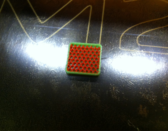

My first dual color calibration square - I'm so proud! (not) :lol: :lol: :lol:
Dual-first print.jpg (286.95 KiB) Viewed 19478 times

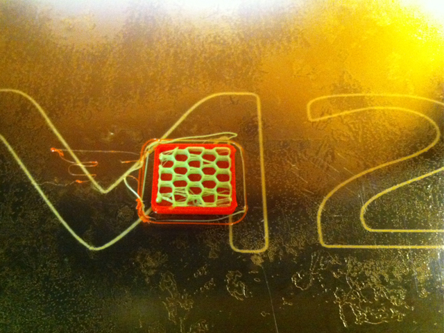

I have one complaint: After spending the better part of the day fine tuning each extruder's settings in the "normal" operating mode, (the one where you use one extruder for the print and one for infill), I went to print a dual color print using the Dual Extrusion Wizard. Well, there is no way to import an individual extruder's settings into the wizard, you basically have to go in and set it up again inside the wizard. Not! Cool! :?
And i ran into another problem, which you guys might have also seen - I've got some seriously different Z-Offsets for the two kinds of PLA that I'm printing simultaneously. How are you handling the Z-Offset issue? Do you take an average for the two? Because if i use one, the other filament either squishes the first layer too much or air prints and doesn't stick well. (It's rare, but there's one that i print that i really like but it has a really weird Z-Offset. Waaay out of range of the other PLA that i use. Even tried fiddling with the extrusion multiplier and 1st layer heights for that one - with no luck.)
I'm sneaking up on it though...... :D
Getting Closer.jpg (187.47 KiB) Viewed 19478 times
