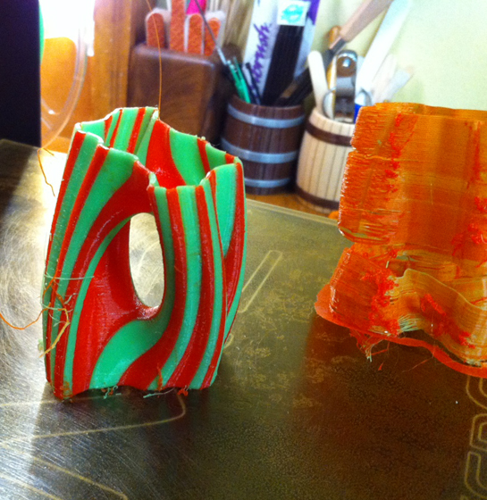

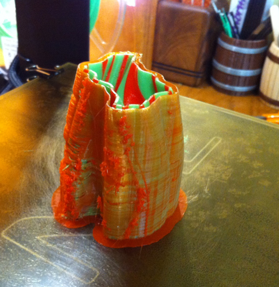

Okay finished the little vase, and I'll post some pics at the end - I'm actually pretty pleased with the way it turned out. Biggest thing I have to remember is to keep ungrouping processes and models if I have to make individual changes to one part, but I'll get used to that. (It does take a heck of a lot longer to set up one of these things.)
Second biggest thing is that if you use a shield on it, attach a hefty brim to the shield. They tend to pop off about halfway into your fifth layer otherwise. :lol:

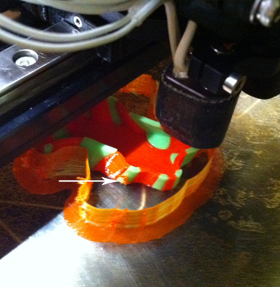

If the shield is too far away from the object, (as it tends to be for a twisting vase that's narrower at the bottom than the top), it has limited effectiveness and i got a few dribbles on the print at one point, but the shield is pretty effective:
Early Dribbles.jpg (252.81 KiB) Viewed 17370 times

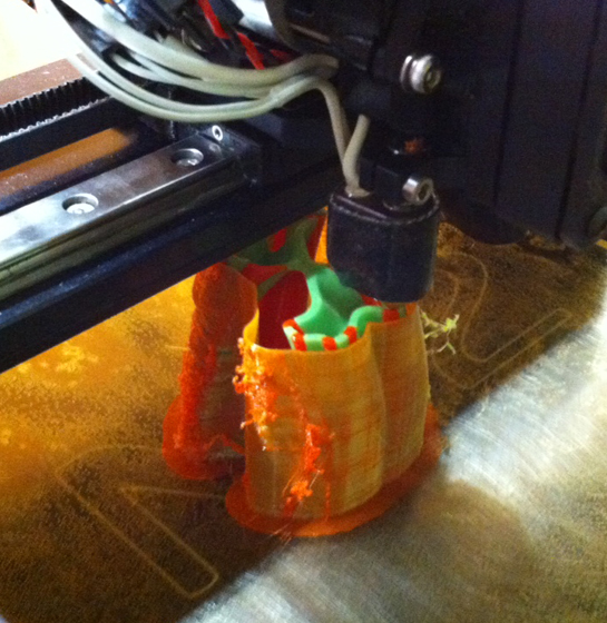

'Bout halfway through, lots of oozes caught:
Halfway Point.jpg (258.69 KiB) Viewed 17370 times
Mount Vesuvius:
Done!
And the unveiling....only problem was the shield got a little to close to the print on one edge and stuck a few fibers to the print. They pulled right off though, so it worked pretty well.
Looks a lot better inside. :)
Unveiled Result.jpg (325.31 KiB) Viewed 17370 times
Overall, not too shabby for the "mostly default" S3D settings with a little fine tuning. :D
(Thought folks thinking of getting a dual might want to see a bit of the process in pictures.)
