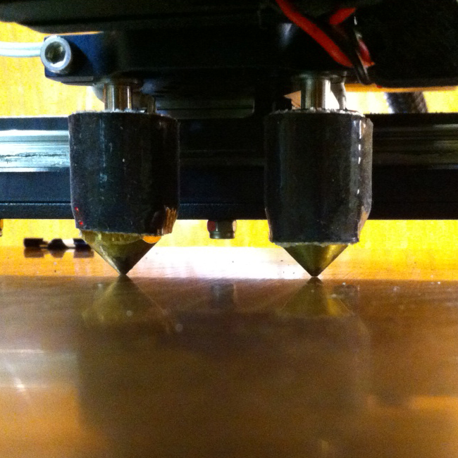

1. Clean any drips off of the nozzles if you have extruded through them. (Tweezers are good for this while the nozzle is cooling off.) You need a clean flat nozzle surface for this.
2. With the extruders and bed cold, slowly raise the plate up past the Z-End Stop, until it actually touches the left nozzle. (Nozzle 0.) Tape the Z-Knob into place so that the bed doesn't move.
3. Loosen the screw that holds the right Hot End (1) in place, and press it down with a small hex wrench until the right nozzle also contacts the plate.
(Do not let the Hot End rotate in the holder). Check the gap from eye level. There should be none. Tighten the screw.
Cold set. Both Nozzles touching.

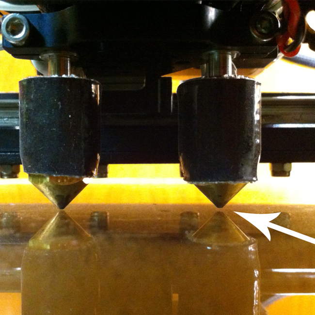

7. Carefully (gonna be really hot in there :shock: ) loosen the screw that holds the right Hot End (1) in place, and press it down with a small hex wrench until the right nozzle also contacts the glass. (Don’t let the Hot End rotate in the holder.) Check the gap from eye level. There should be none. Tighten the screw.
If you let the plate and nozzles cool in place you will see a larger gap under the hotter nozzle, which is what you want. Now when you set a Z-Offset it will apply equally to both nozzles, despite the different filaments and temperatures. :D
Hot set after Cooling off.

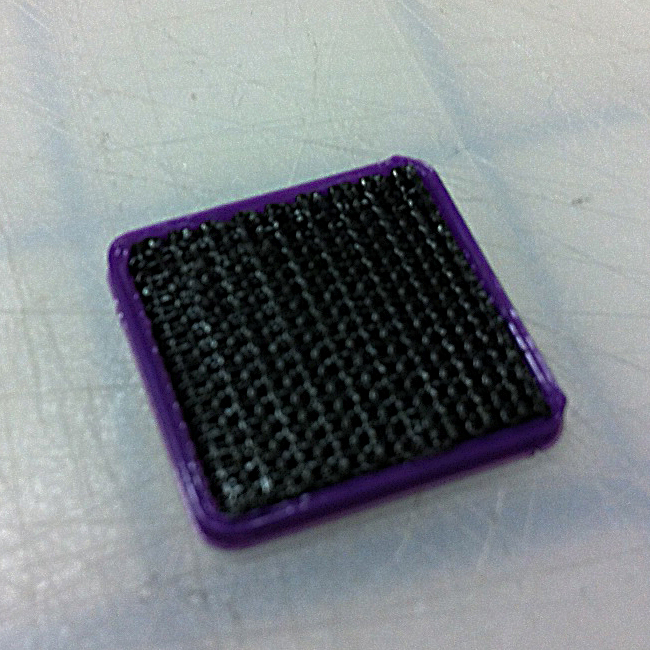

I printed a PLA calibration square with high PETG infill, just because i wanted to see if I could....Yep! It worked. :P
Purple PLA square with PETG infill. Just because.

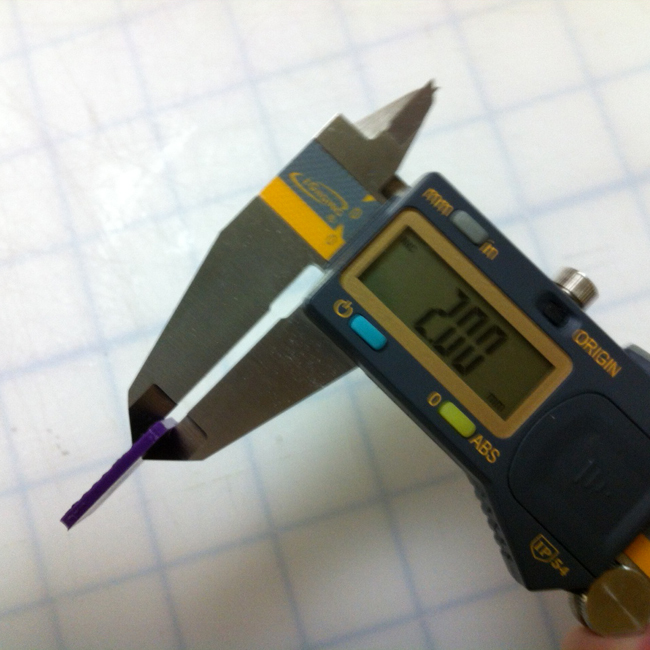

Perfectly! :D
Water fill flat.
(By the way - not advocating PETG as infill for PLA - they don't bond. This was just to see if the gap setting method worked correctly.) :D
