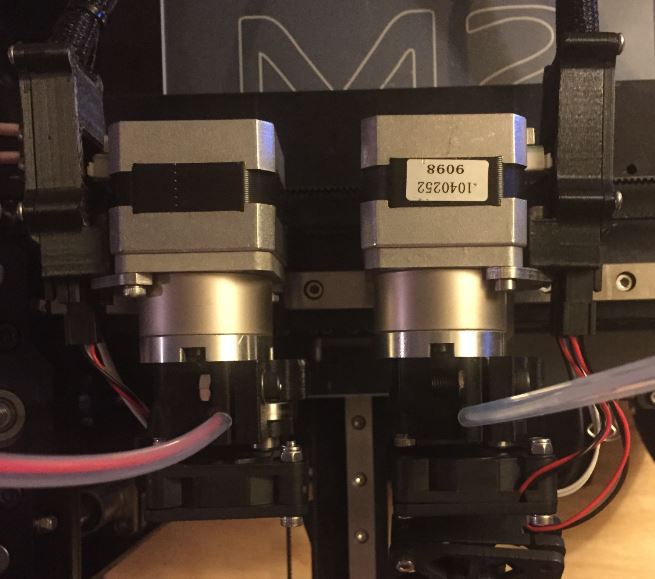

I'm new to the forum here and just came across this thread, but have had a M2 at work for a year or so and recently got a lightly used one to play with at home. I upgraded the work one a while back to the factory dual extruder but wanted to do something a little different with my personal one. I didn't really want the non printing extruder moving around over the print area. I've mounted the second extruder on a separate carriage by using "Mirrored" Makergear parts. For the left motor mount I just flipped it around and drilled 2 new offset holes in the mount so the motor was positioned correctly. The 2 carriages are tied together with a couple of different lengths of aluminum strips across the back of the motor. This gives me the ability to put them for enough apart that only one at the time is over the print or to space them very close together. I never print anything large but often want to print 2 of something. This gives me the option to place them a little further apart and let them print in sync with other and get 2 parts in the same time as one would take. I also made a mirror of the newest wiring harness mount left side which keeps the wires nice and tidy.
Ultimately I would like to add a second X-axis motor and belt so each extruder can get out of the way while the other is printing or let them print as duals. I originally assumed this would take a lot of firmware but after spending a few night getting familiar with the firmware it appears there is a command M605 that will handle the second extruder and carriage. I've followed it from where it is received and parsed from the serial port up to the point it steps the motor. It appears to be a functional command. In looking at the Rambo board it appears to have provisions to provide extra step and direction signals to an extra stepper driver which would have to be added on a separate board. The 605 command has a couple of options, slicer handles everything, firmware parks and unparks both extruders and finally they can act as dual extruders.
Is there anyone else who is familiar with the M605 command or who has good working knowledge of the firmware?
Mike

But meanwhile. . . how did you get a mirror-image metal motor mount bracket? I want one of those! I've been wanting to switch to the metal brackets, but with my dual extruder setup, two brackets, as sold, would keep the extruders further apart than I would like. By contrast, a reversed metal motor mount would allow me to get the motors just a little bit closer together than I can do with the printed mounts.

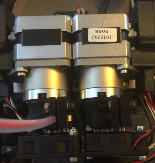

The metal mount normally uses the front 2 holes in the carriage. I just flipped it around and used the back 2 holes. This requires drilling 2 new holes in the motor mount with the new holes being just behind the old ones. You would need to measure and make sure, but I think I remember them being about .160" behind the old holes. The mount is stainless, I used a mill to get them in the exact location. This setup will allow the two motors to actually slide up against each other and touch.
I would be interested in hearing what you have learned about the dual prints. I'm an EE with embedded firmware experience at a previous job, but I do not have any Arduino experience. From the few nights I've spent looking through the code it appears the M605 command has the ability to do dual prints.
The picture below shows them push up together touching. The distance between them is currently set by using a length of aluminum strip of the desired length under one of the corner screw that holds the rear motor cover on.
Update: I had some time this afternoon to play with the firmare and was able to make a few changes and get the M605 S2 command to work as I wanted it to. When the command option S2 is sent the 2nd extruder extrudes in sync with the 1st allowing dual prints. When the S0 option is sent it defaults back to its normal behavior. I also looked more in depth at adding a second motor/belt for the second extruder and the firmware seems to support it. It looks like it will also require a second home switch. For anyone interested look in Configuration_adv.h and scroll down or search for #define DUAL_X_CARRIAGE. The next several lines of code and comments after that describe how the 2nd X carriage works.
