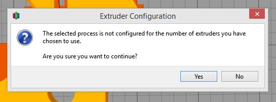

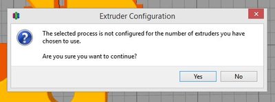

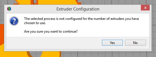

Note: When you send a "non-dual" model to be sliced with one of these Support profiles, S3D might give you the error message below. Just ignore it and continue, the profile will still slice correctly.
Just click YES and get on down the road.

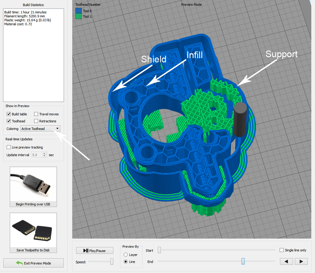

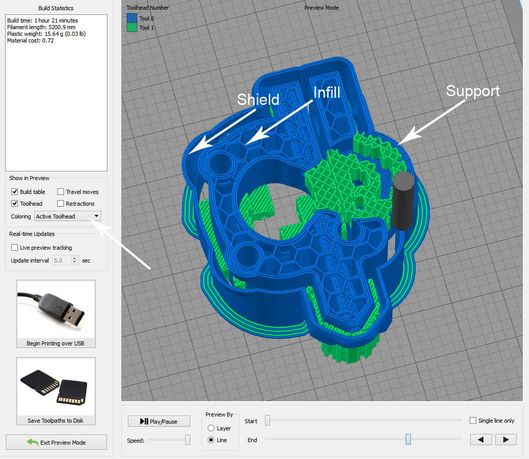

Once it's sliced, click on the box next to Coloring, and choose Active Toolhead. That should show the left nozzle part of the print in blue, and the right nozzle (PVA) part of the print in green. The supporting filament should only be the Support part of the print, (and a bit of the Brim), if it sliced correctly. The shield is going to be all blue, which is your main print filament.

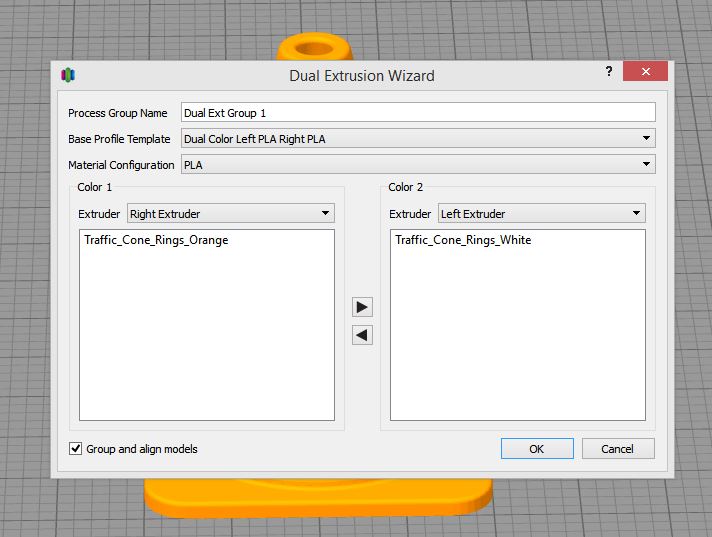

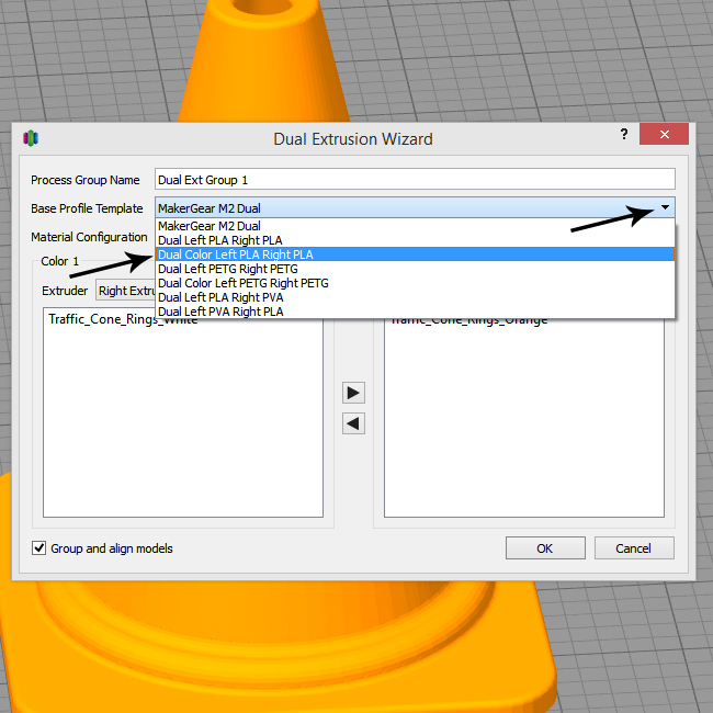

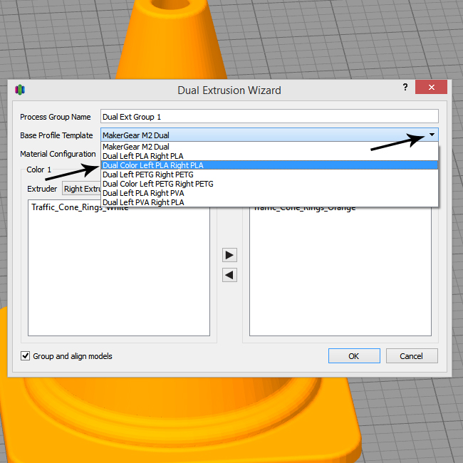

Click on Tools > Dual Extrusion Wizard.
Select the Dual Color Profile in the drop-down for the Base Profile.
Choose the Dual Color Profile you wish to use.

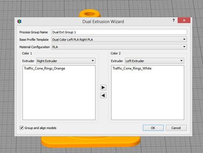

Choose which color you wish to assign to each extruder.
Decide which color for each extruder.

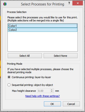

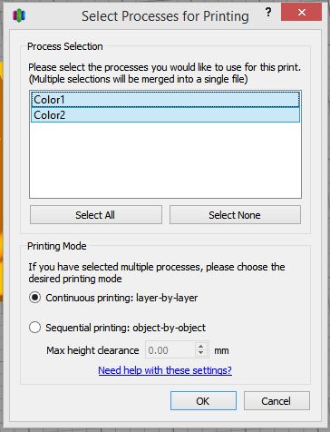

When you get ready to Prepare to Print, choose both the color profiles shown.
Slice the print by selecting both Color Profiles.
Select All.
