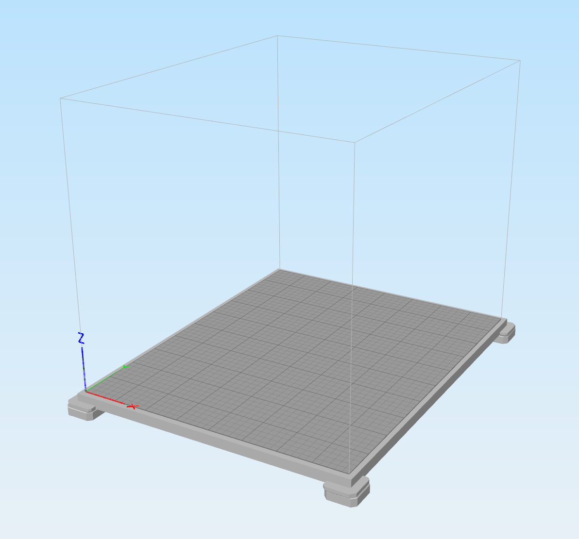

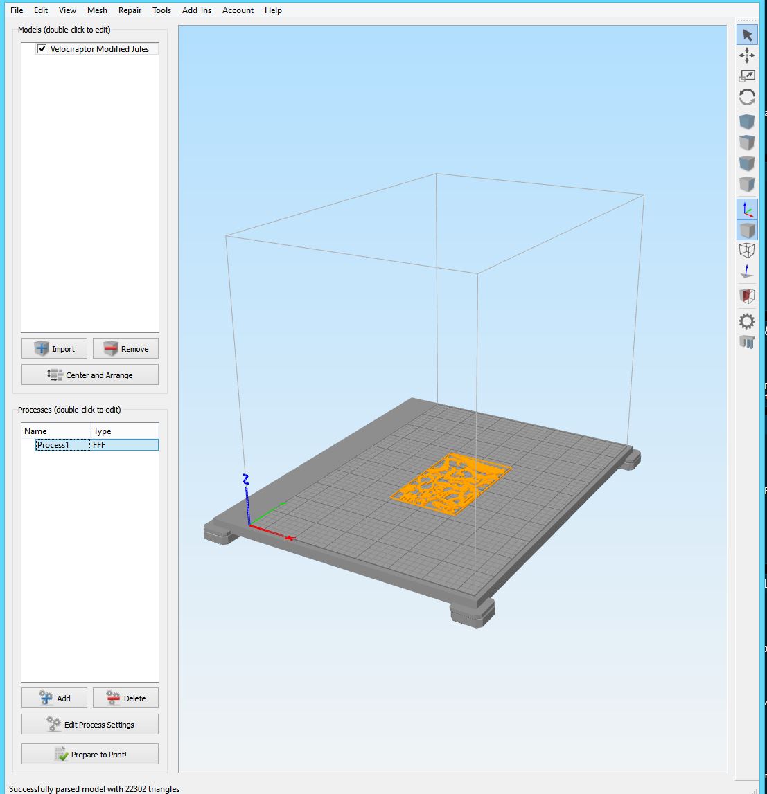

Not sure if possible, but is there any way to get the bed preview to use the single extruder .stl in simplify3d when using the left / right extruder only profiles?
This is what's currently there:
This is what I would like:
The problem with the way it is currently, is that the left only profile CAN use the entire bed, but the way it's represented, if you were to use the furthest right part of the bed, it prints off the side. If it used the single extruder representation seen in the "preferred" image, it would never look like it's printing on the bed while actually being off the bed due to the correct visual style.

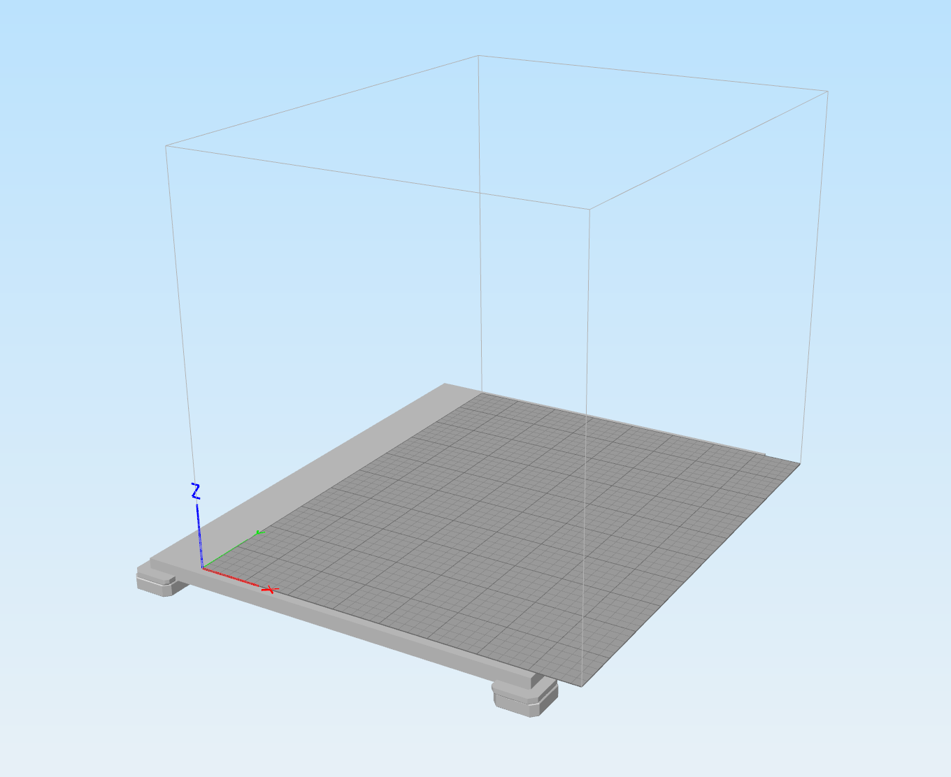

Well "Butter my backside and call me a biscuit!" I just found it. :lol:
Go to Tools > Options > Models and in there is a selection about using the old method of viewing. I have no idea what it said originally, because once you implement it - the whole layout goes back to the older one, and you no longer have the option of changing it back. The software will warn you to remove any prints on the board before it lets you change.
I have no idea if it actually works or not with the dual - in order to go back, you will probably need to uninstall and re-install S3D.
At least the grid isn't hanging off of the base anymore:
