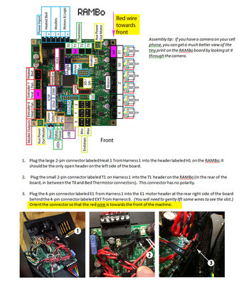

I think one of the issues you are seeing is from turning the E1 connector backwards in the Rambo. The red wire on that connector needs to face towards the front of the M2.
From the description in the installation instructions....it's number 3. on the page.

I suspect that you had the outdated assembly instructions based on when you received your printer with the upgrade.....you need to send me a private message with your email address so I can send you a copy. It's similar to the one you used, but there are differences in it that are very important.

Thanks for this - I just checked and the red wire does face the front of the machine.

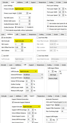

Whenever you get back to this, I need you to try a couple of things:
Regarding getting the right nozzle (Tool 1) to print:
1. Heat it up first using the jog control settings panel. Try using the jog controls in S3D to extrude 20mm at a time for a total of 100 mm from just that nozzle. (Tool 1) If it does not extrude, retract the filament completely (100 mm) using the jog controls, pull it out of the top as it is retracting (slowly and sometimes very firmly) and check that there isn't a jam or something in the nozzle. Check the tooth marks on the retracted end of the filament and make sure you have the correct bite marks. (Filament Drive Tension screw setting.) (Cut the end on the spool perfectly flat before you try to feed it back in later.)
viewtopic.php?f=3&t=2694
Once you are successful with that.....
2. Try to print a calibration square (or anything small) using the MakerGear M2 Dual default profile with each of the individual extruders.
(Okay, it occurs to me that the new users don't know what a calibration square is......here's a download....Ed came up with this and it's perfect for testing....prints in about 3-4 minutes.)
When you print from the left nozzle using the default profile, you need to make sure that you have set a Temperature for each nozzle on the Temperature tab in the default profile - I just noticed that it lists 0° temp for Tool 0 on the default. (That is an error in the S3D default, that i just caught because i don't ever use the default.
When you print from the right extruder, you will need to change the Tool that you are using from Tool 0 (left Extruder) to Tool 1(right Extruder) on each of these pages in the Advanced S3D profile settings:
Let me know if any of that works/doesn't work.
