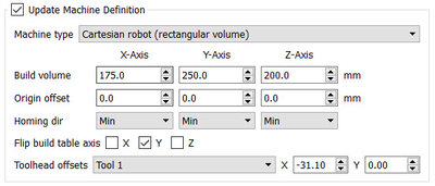

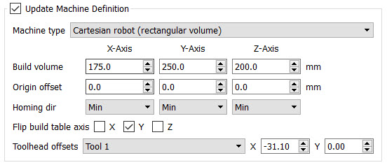

I moved the actual print center point closer to the center of the bed by using an X-Offset of 25 mm.
(Please note - that is the Global X-Offset slot on the G-Code page, not the Z-Offset.)
But.....although the actual print will land near the center of the plate, the image on the screen version of the bed is going to appear to be sitting off to the right.

I am still struggling with this. When using Simplify3D it is pretty close when it actually prints for both extruders. I am trying to get use to using Octoprint currently. I am just about to a point I can use it to my satisfaction. It seems like it doesn't use the same parameters as Simplify as it prints way off center when it uses a gcode created by Simplify. I thought is was an error on my part but it has happened repeatedly. Any ideas what I am doing wrong?

OctoPrint is merely a host program. Its main job is to send your gcode file a line at a time and wait for a response from your printer. That's it. Whatever results you get are entirely determined by the contents of the file. So if your print is off to the side, you need to adjust the gcode generated by Simplify3D. If you print the same gcode file via flash card or S3D, you should get the same results. If that doesn't happen, that is interesting and warrants investigation.
Re: Dual Offset

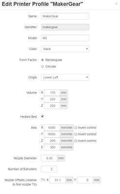

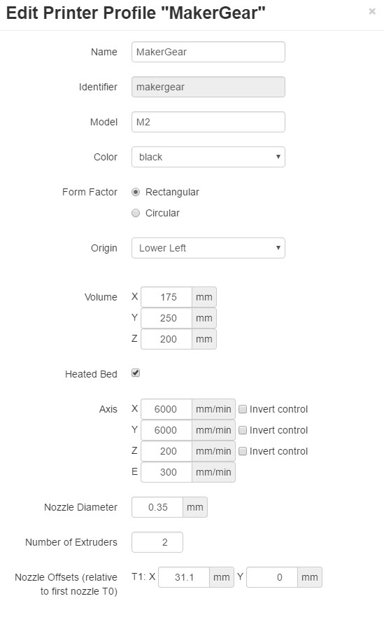

I figured it out. Apparently I messed up a setting in Octopi. It pertained to the offset for the dual extruder. I matched what the default Makergear Dual profile had (-31.10). Apparently that was incorrect and it should be 31.1. My current settings are below. The other item I noticed is that the jog for Y in Octopi is reverse of what I would expect. Clicking the box that reverses it also flips the model upside down when looking from above though so I just left it as it isnt something I commonly use.

Re: Dual Offset
When you say the Y jog does the reverse of what you expect, what do you expect and what does it do? Pushing the up button should move your bed towards the front.
Re: Dual Offset
To reverse the jog movement check the "Invert Control" option in the second screen you posted.
