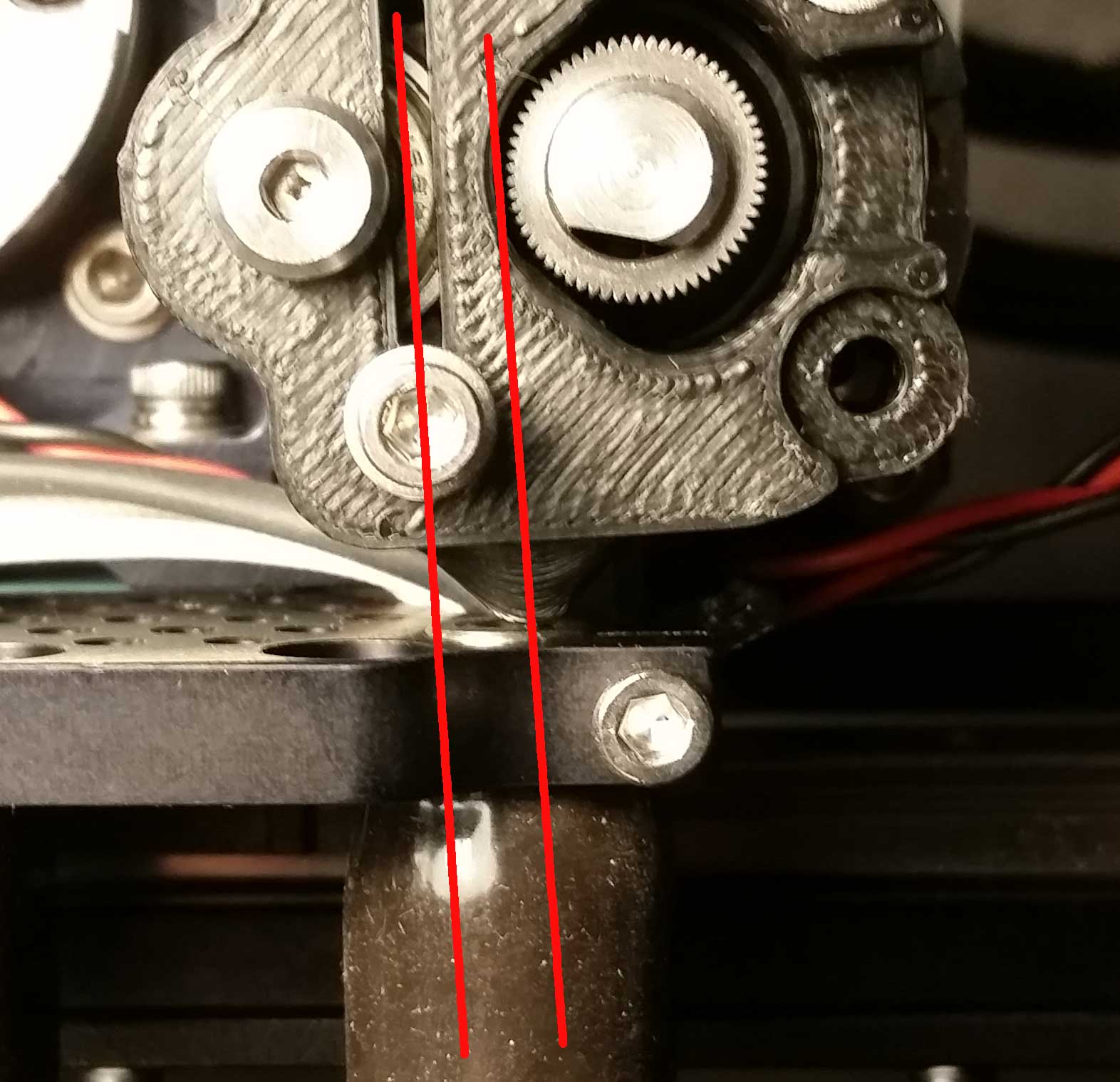

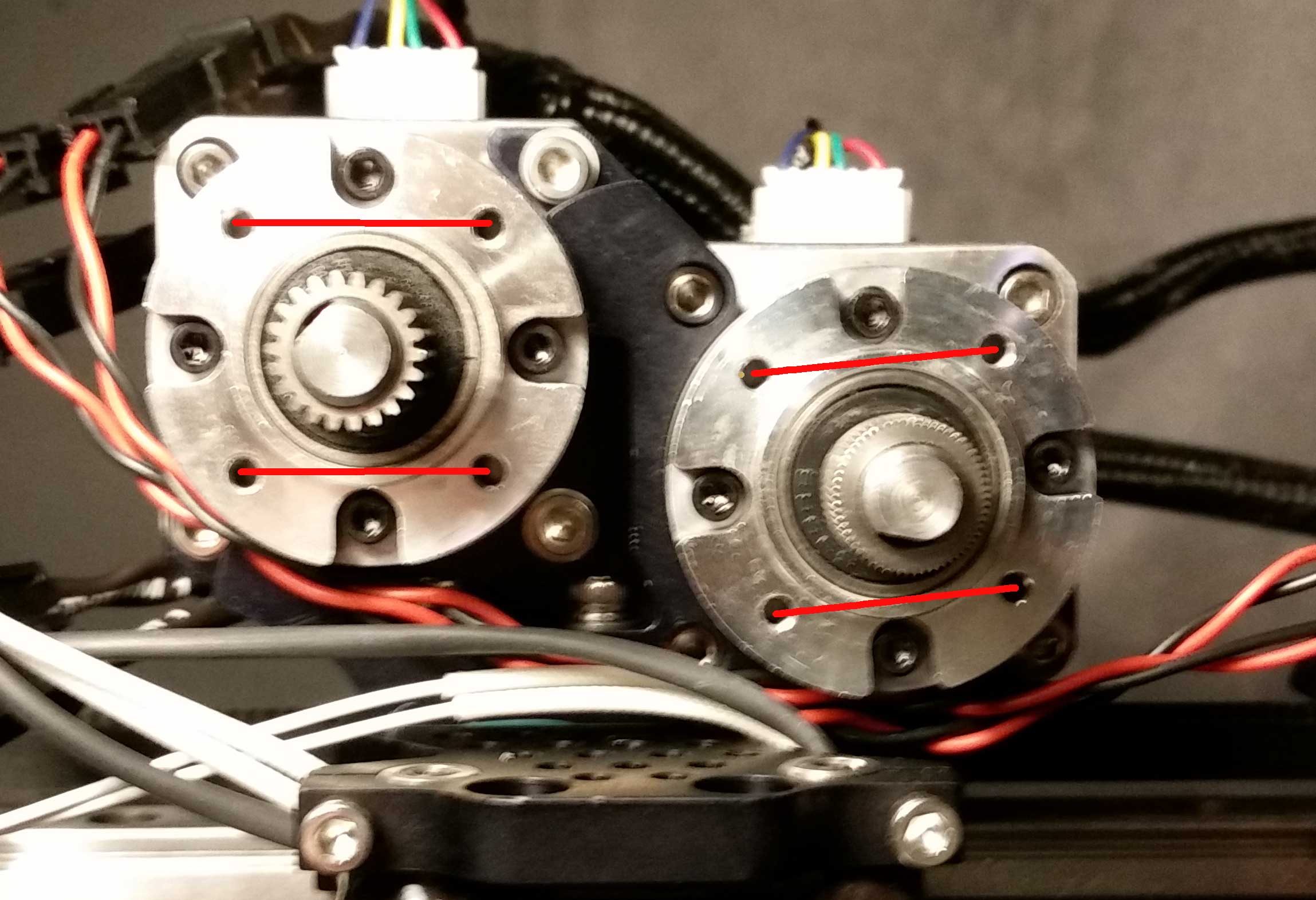

Ok, this one is a doozy as far as I'm concerned. I'm going to email MG support.
Motor 1 is crooked:
Which is causing the filament drive to be rotated:
Re: Upgrading Rev E + LCD to dual: Which firmware?
Post by Jules » Thu Nov 03, 2016 1:33 am
You have dissimilar filament drive gears....one of them is the old style (the one with the deeper teeth on the left) and one of the newer ones with the shallow teeth. (Unless the one on the left is the old one that hasn't been changed yet.) I think you'll want both of those to match, for consistent treatment as well.

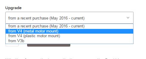

I've already added that to my list :D. I specifically chose this one from the shop because I purchased mine in March of '16:

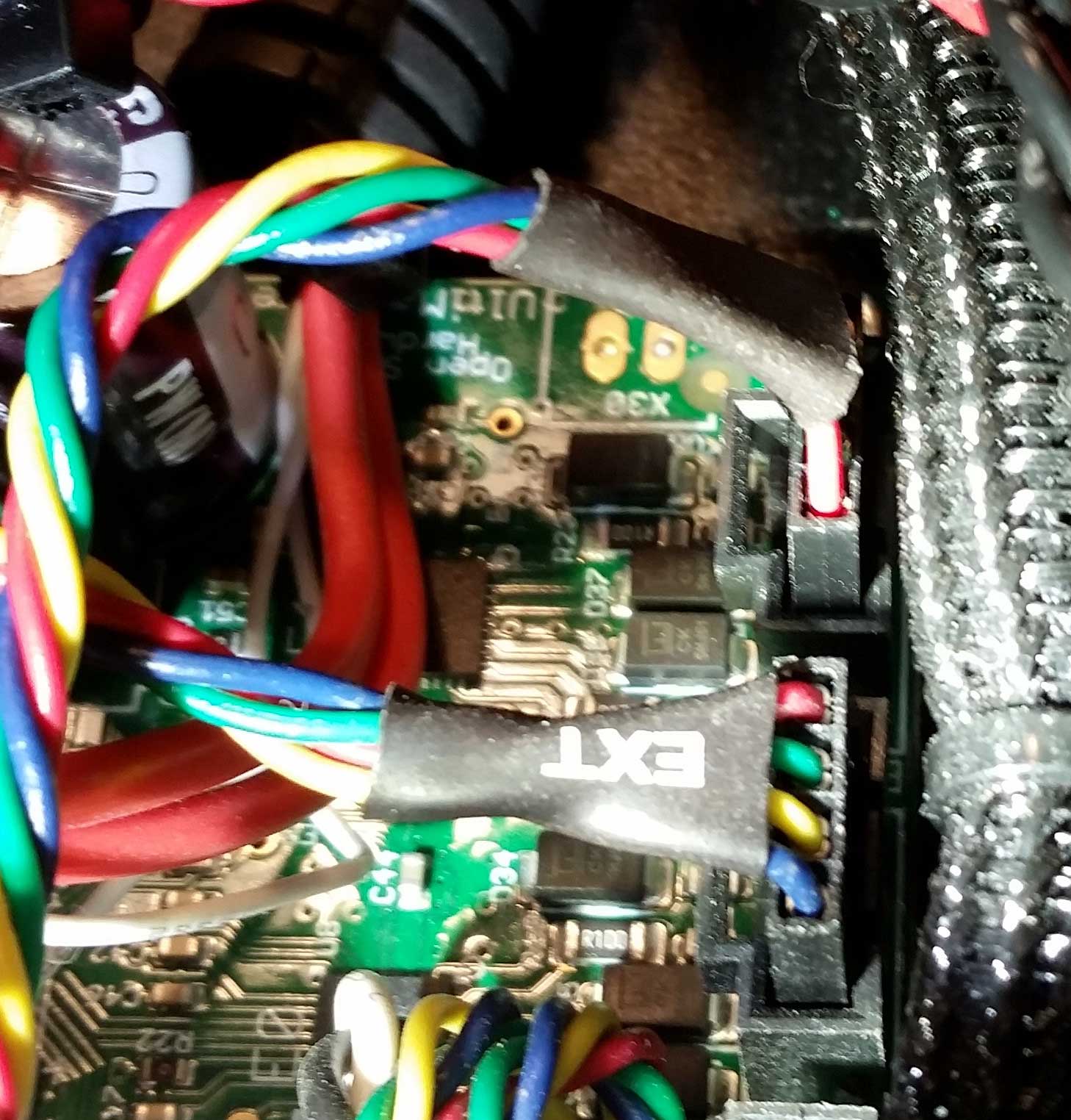

Hugs wrote: Page 7 "RAMBo"
  1. The image with the arrow indicating "Red wire towards front" can be misleading. The wires were twisted so there's no guarantee in which order they're visible.
I understand this one now....
If you plug in the "E1" connector to match the existing "EXT" connector (i.e. the label facing up so it's readable), the right extruder will run backwards. So you have to orient the red wire as it enters the connector towards the front of the printer. I had to push the heat shrink back a bit to see the colors.
Sorry for more potato pics but the guide makes sense now (this is the correct orientation)
