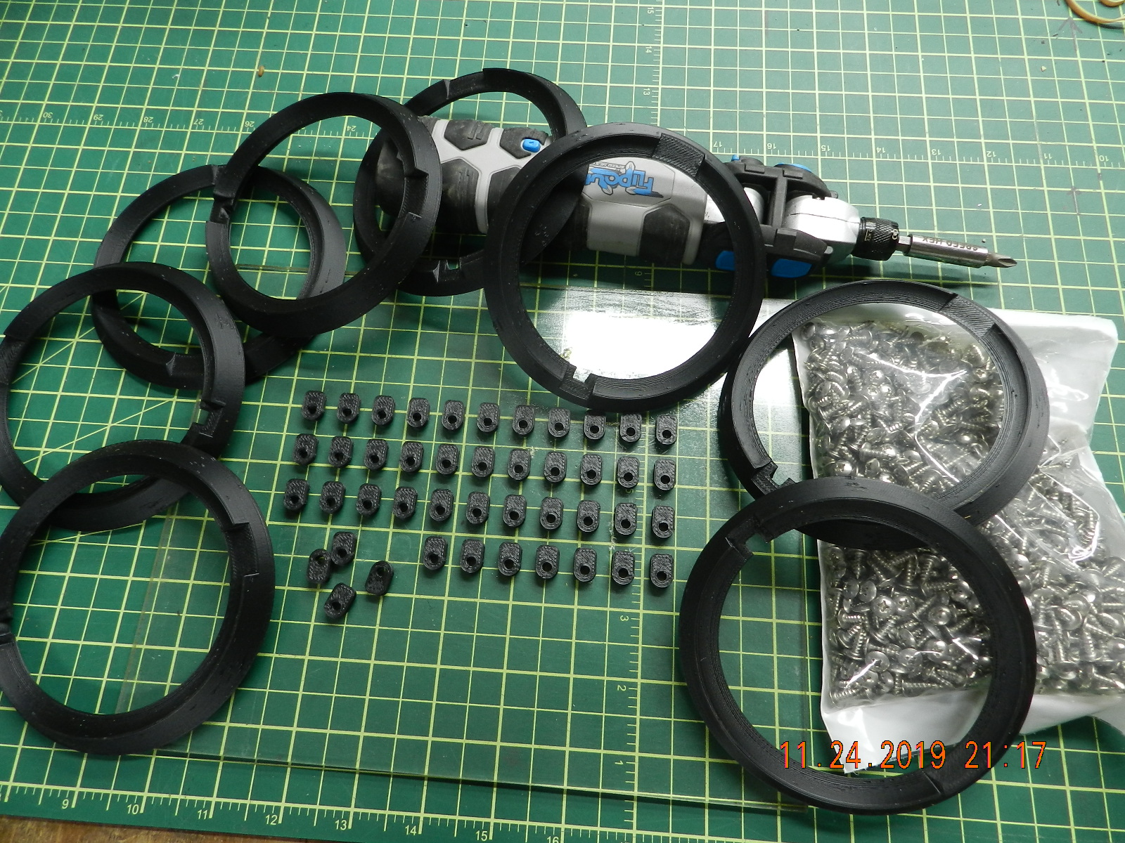

Purchased this kit when they first came out. New hot end is way better than
to old one. I am currently making production parts with hot end 0.
