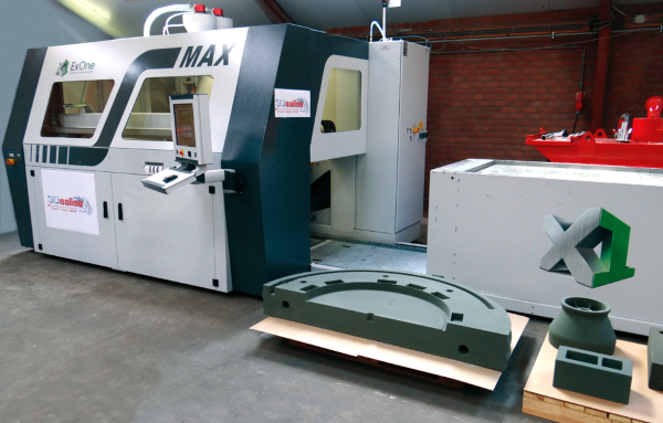

Or you could just print the whole mold out of sand :lol:

Post by Mark the Greater » Mon Aug 10, 2015 6:55 pm
I always forget the password to my ExOne though...
