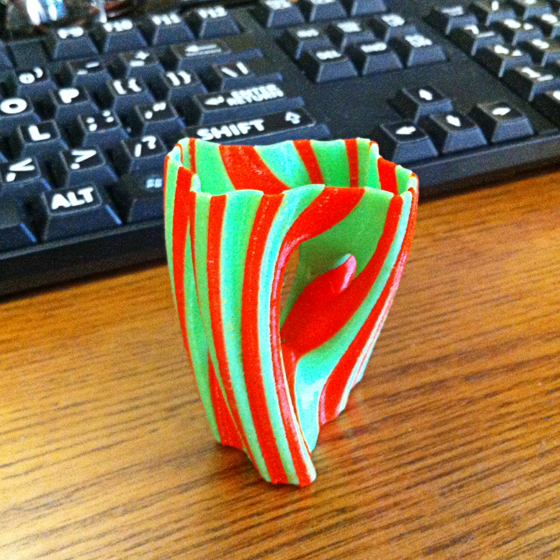

4. No multi head printing ability.
...Wrong. Dual Extruders are currently available as a kit upgrade for an additional $300 over the base price. (And worth it.)
If you're purchasing multiples of these for lab use, I would recommend keeping one as a single and using the others as duals if desired. (It's just a lot easier for beginners to learn to use a 3D printer with a single extruder first.)
