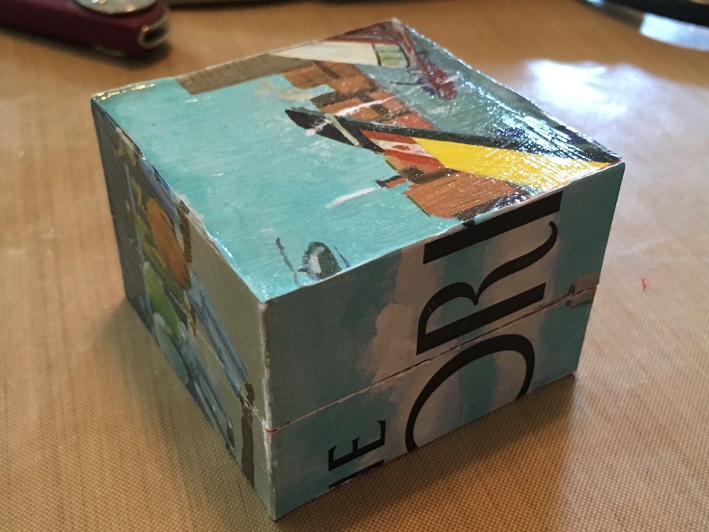

I bought some Mod Podge to try it out as a surface treatment for 3D printing. It wasn't very successful as I attempted it on a sculptural print with a lot of nooks and crannies where it tended to collect. I think it would work better for flat surfaced models, but it ends up with a brushed texture so I'm giving up on that.
Then I decided to give it a go with its traditional use in découpage, or "the craft of gluing paper onto things". It gives an interesting look to planar prints where it can be applied. Here's my result; note that it is my very first try at this, I made a lot of mistakes and it's not the best example of the craft.

I like that....does the box open?
Re: Decoupage
Yes, it does open, the model is this one: http://www.thingiverse.com/thing:9602
I thought I would be clever and do the sides as one big loop, then split the seam afterwards. I left one side unsealed before attempting the split and that frayed the edge rather badly, so I think this box is going to be chalked up as a learning experience.
The hardest part is cutting the paper to size accurately. I was thinking that with a craft cutter (or Glowforge, come winter!) you could get some impressive results, like inlaid embosses.

Wait second - did you decoupage a printed box!?!jsc wrote:Yes, it does open, the model is this one: http://www.thingiverse.com/thing:9602
Re: Decoupage
Where else am I going to get a cheap box to mess up?
Some stuff I read seems to indicate that it doesn't really work great on certain plastics, but PLA seems to work fine.

Whoa.....that opens up some serious possibilities! i thought that was one of those little chipboard ones that they charge you 6 bucks for at the hobby stores....... Awesome!
I didn't think the glue would stick to plastic at all.

very interesting and a good job. actually now i want to try gold leafing a print.

Spray adhesive works well. PLA is very friendly.Jules wrote:Whoa.....that opens up some serious possibilities! i thought that was one of those little chipboard ones that they charge you 6 bucks for at the hobby stores....... Awesome!
