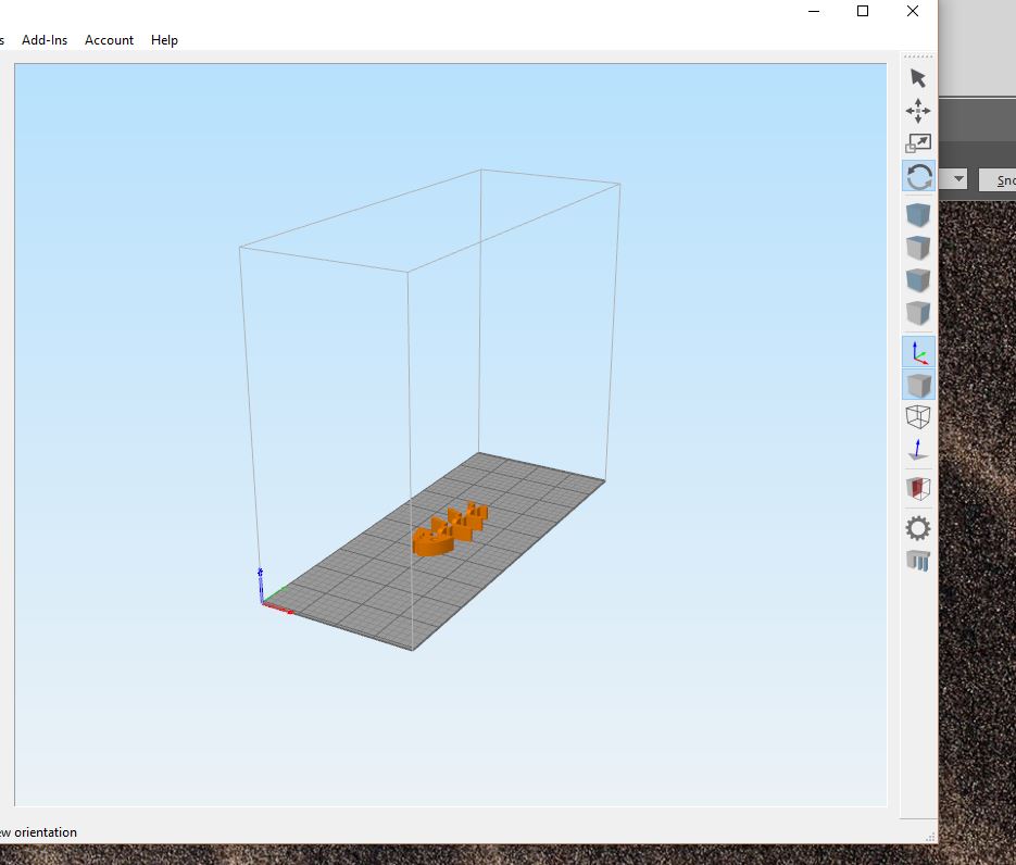

Perfect - thanks so much for the help and advice. I tried a few prints yesterday using the "duplication" FFF file in Simplyfy3D and it worked great. The size of the bed is decreased by 1/2, and every setting changed in Simplyfy3D for the T0 (left) extruder gets "duplicated" for the T1 extruder. I did have to make a few adjustments to the ooze shield and skirt/brim setting so everything fits on 1/2 of the print bed.

I also setup a print using T1 or right head. The image in S3D cuts the bed in half so I figured as long as the model was anywhere in the graphic I would be OK.... Well that wasn't the case, the right tool head T1 will hit T0 if the model is too far toward T0 in the graphic???? Should be some sort of coding to to figure out if there is going to be a problem.
