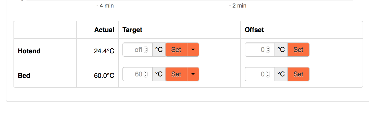

Ok, i found the profile and now i finally got it to work,
it's printing fine, but in octoprint, im assuming the left hottend temp is being displayed, i have no control over the Right Hotend.

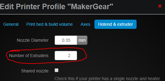

spatterfree wrote:[...]but in octoprint, im assuming the left hottend temp is being displayed, i have no control over the Right Hotend.
I'm being Captain Obvious here, but did you set the number of extruders to 2 in the Octoprint printer profile?

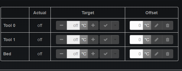

You should see both extruders in the Control tab:

Post by spatterfree » Tue Feb 06, 2018 5:27 pm
no, i didn't, i made a profile for right extruder only.
