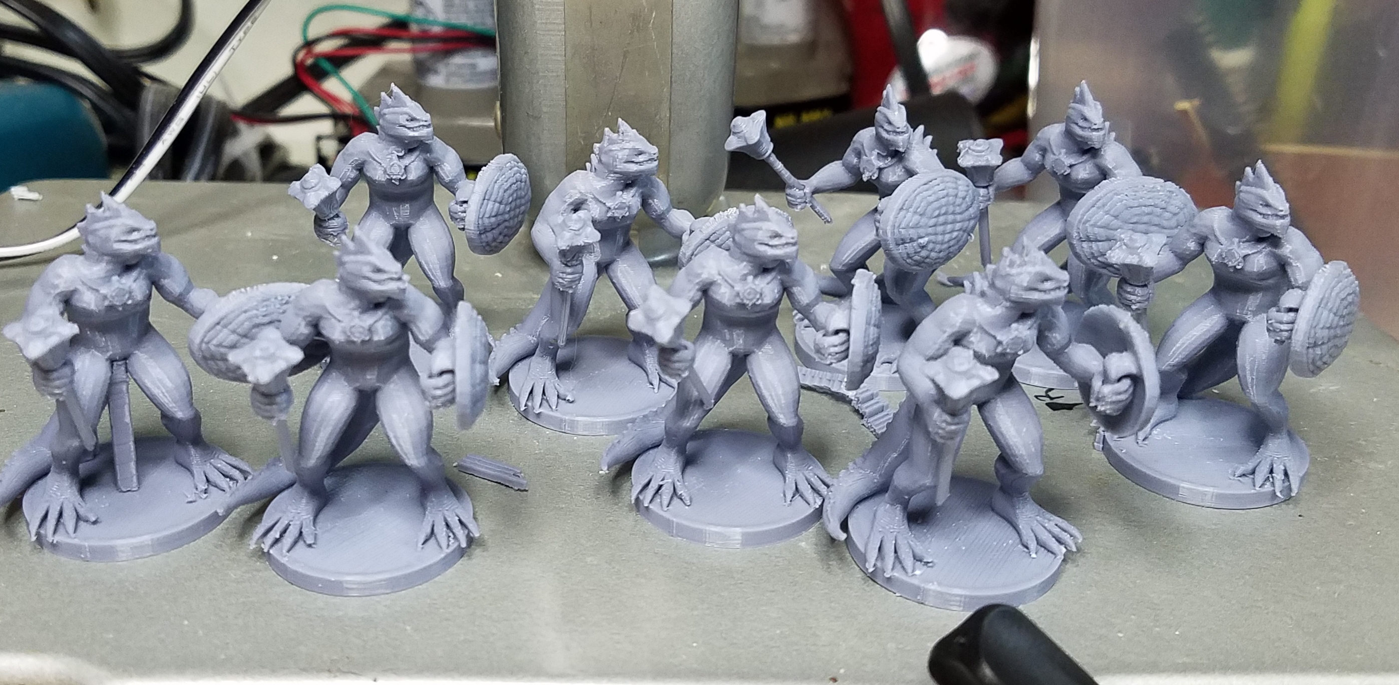

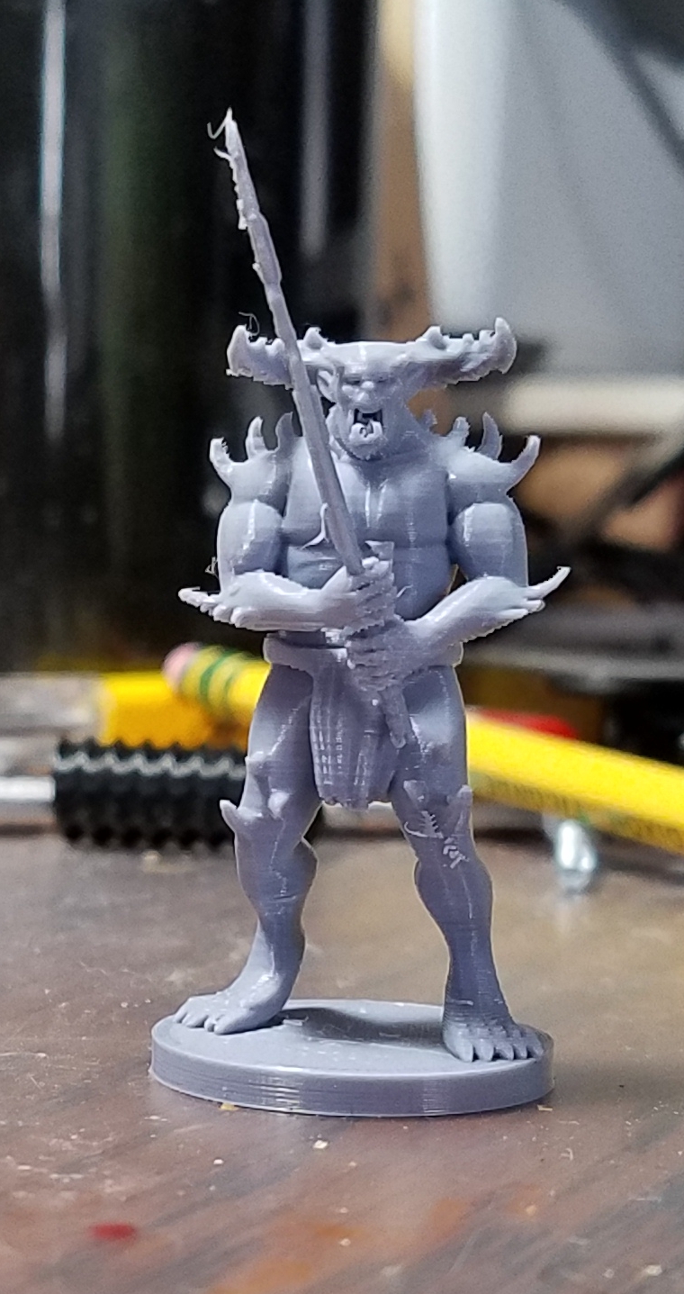

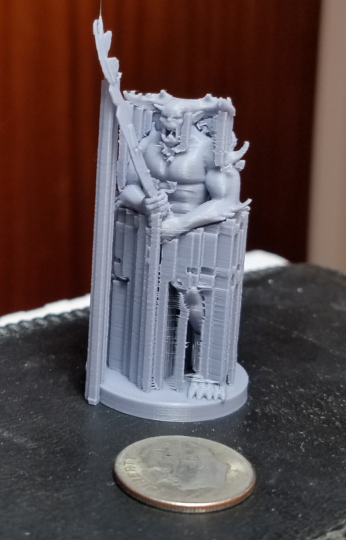

I have an M2 and have been printing miniatures for a coworker for weeks and it was a long road.
I have been using the .25 nozzle with a .25 Extrusion width. It is important to get your multiplier and starting height correct as even slightly over extruded will make removing support very difficult. Some models let you separate parts from the model so swords can be printed flat but not all do that. I will PM you my email address so you can contact me with any questions as you progress.
