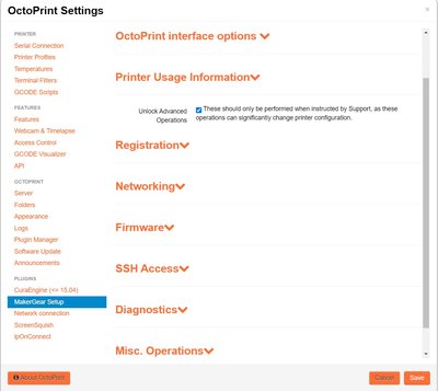

Hmm, I cant find that option in my Octoprint settings menu. Can I buy another clue? ;-)

Post by gbroters » Wed Jul 08, 2020 9:00 pm
paynterf wrote:
Mon Jul 06, 2020 7:06 pm
Hmm, I can't find that option in my Octoprint settings menu. Can I buy another clue? ;-)
No need for any quid pro quo!
There are two ways you can safely do this:
The first method is much faster, but it requires you to backup the entire 16gb SD card. This can be done by using a program like or similar to "Win32DiskImager". Here is a great guide on how to backup your SD card.
Foosel (The creator of OctoPrint), has written up an excellent guide on how to manually backup your OctoPrint settings: Unfortunately, I had mistakenly logged into an Ultra One printer that was running a later version of OctoPrint (Which has the Backup & Restore plugin built into it...). We here at MakerGear are actively working on updating the OctoPrint version for our M3 printers and we can't wait for you to try it out!
