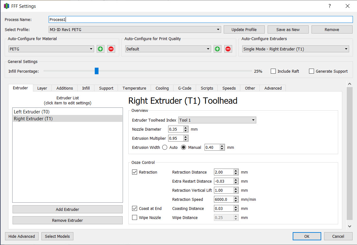

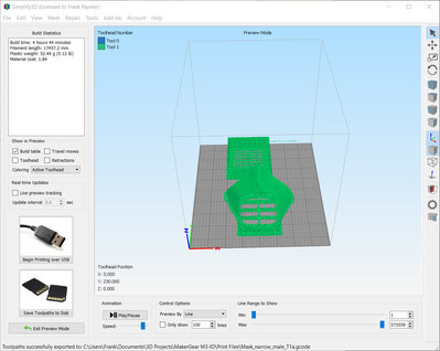

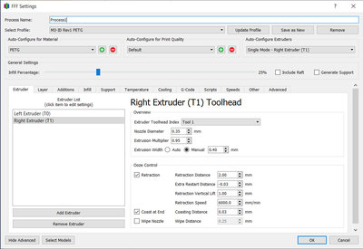

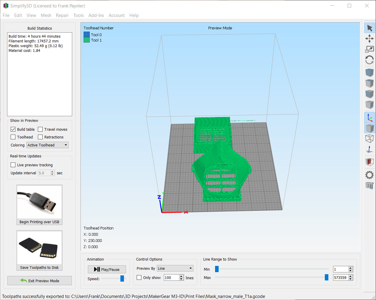

Hi,
I'm using S3D to slice, using the stock M3-ID Rev1 PETG profile, with 'Single Mode - Right Extruder (T1)' selected. When the model is sliced, the S3D preview screen shows all layers being printed with Tool1. However, when I upload the file to the printer via the web interface, the right (T1) extruder heats up, but all the move and print commands are being directed to Tool 0 (right). This results in a flood of 'cold extrusion' warnings which forces me to power cycle the printer to regain control (I can't shut the printer down using the web interface due to the flood of warnings).
