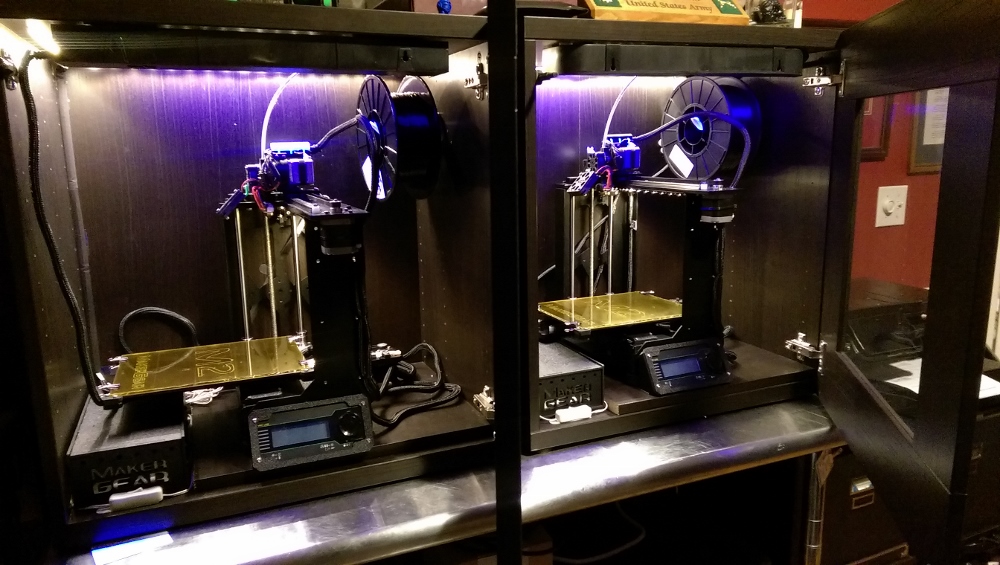

This thread inspired me and I enjoy the cabinets... Quiet printing, temp control, looks fantastic...
They are unmodified Ikea Besta cabinets... 23.5" wide, 25"tall, and 15.5" deep. The printers fit quite nicely once everything is arranged just right.
Regards,
-Don

Re: Modified Ikea enclosure
Here is what I ended up building... some of the Ikea parts were obsoleted, so I had to substitute others - still worked out great! I designed and printed the cable grommets as well as the fan enclosure. I routed the wires for the fan through the inside of the cabinet top and also buried those and the wires for the LED lights in the cabinet grooves that normally receive the cabinet back panel.
