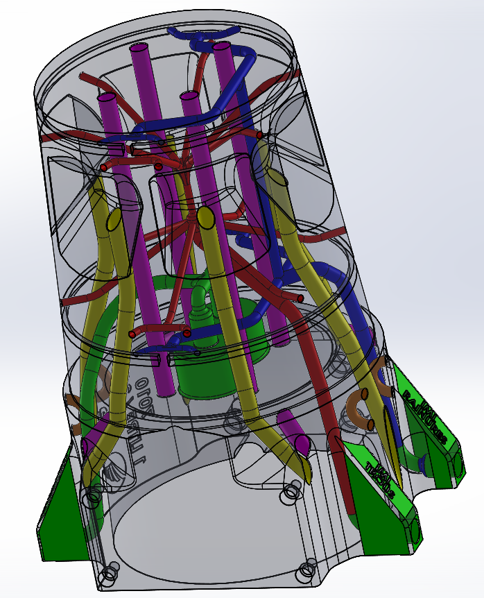

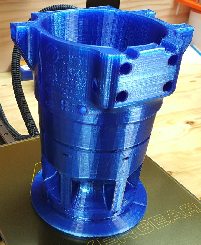

I just designed and printed a tool that will pick up labels and parts in an injection molding machine.
I have three main air channels into that thing (Red, green and blue are each of the channels.)
What I was worried about happened though: the internal air channels are not air tight. When I put on vacuum, I get some succion, but far from what I should. Reading the actual negative pressure tells me that I have a LOT of internal leakage. This was bound to happen as printing is pretty much laminating with plastic... but I was optimistic.

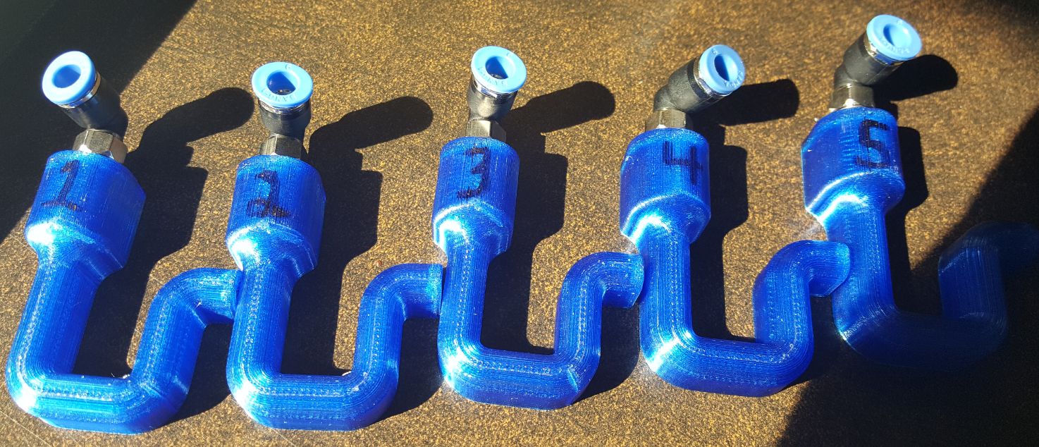

So during the night I printed those 5 samples. All I had today to run my first trial was 5 minutes epoxy, 70% alcohol and acetone. So I used two samples and shot them with diluted epoxy. 1st with alcohol and 2nd with acetone, both using about 2mL of epoxy and 4ml of solvent.
It turned out great actually. I was reading -59kPa and -70kPa on #1 and #2 prior to the application of epoxy. After the first coat, I read -85kPa in both instances, which is the lowest value I am able to reach with my venturi. I am curious to see how it will hold up overtime. Also, I wonder how well that epoxy solution will travel within my mandrin that has many more channels than my small test samples...

I wondered: does acetone have any kind of effect on PETG? I did not find any so far.
