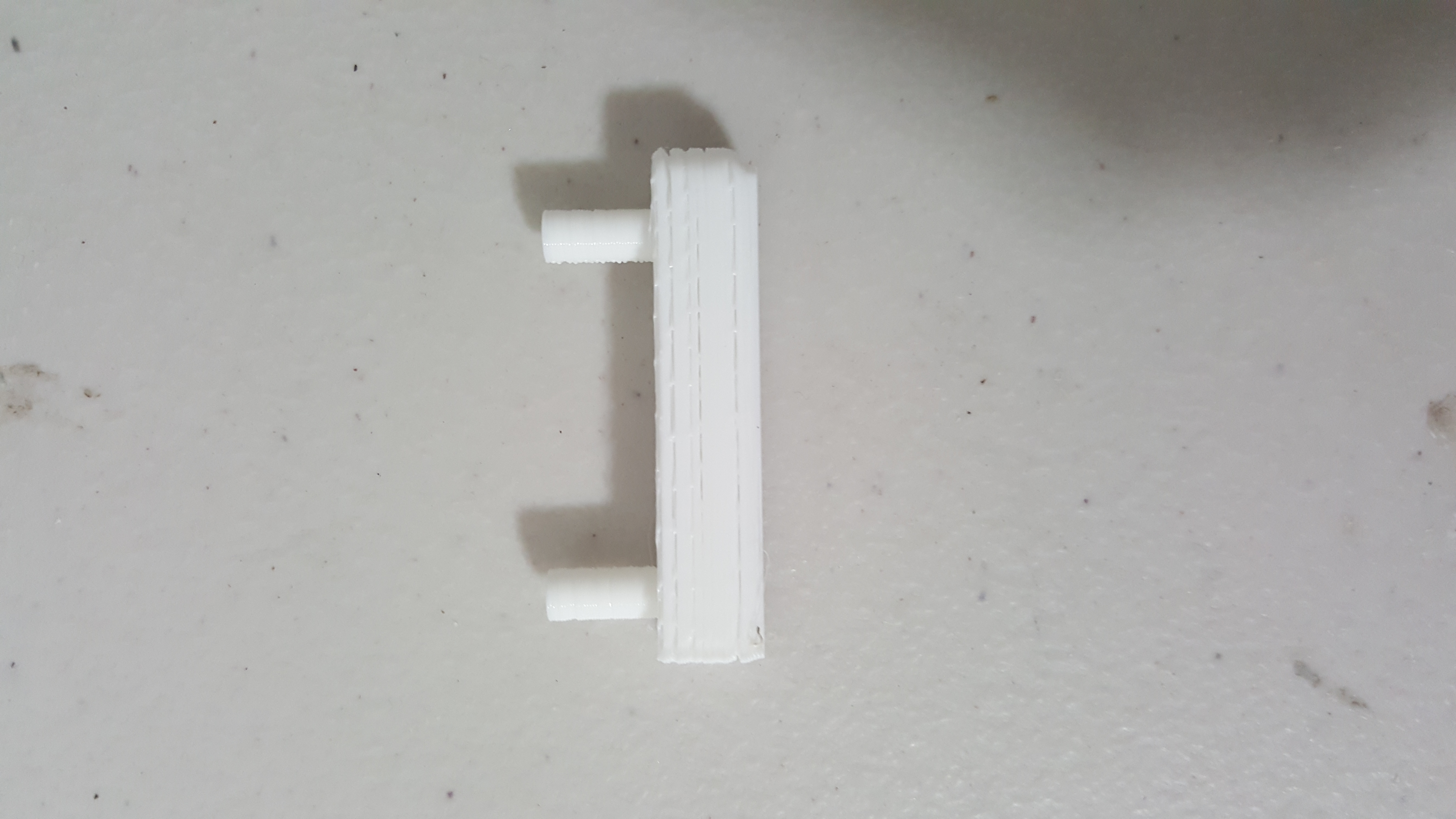

What is the problem with this print?
quentinthornton
- Posts: 13
- Joined: Fri Jul 10, 2015 6:41 am
What do I need to change to fix this? (I linked a picture at the bottom)
Re: What is the problem with this print?
First we need to know what' s wrong with it. . .
Is that ABS or PLA?
It sort of looks like some of my prints when I was using damp nylon. Layers were separated due to vapor replacing plastic at times and otherwise rough.
Have you carried out an extruder calibration? You may be under extruding, which can lead to a rough vertical surface texture. Also, if your nozzle is blowing off steam while printing, then your filament has picked up humidity from the air. Use a fresh batch while you dry it out.
Do come back and tell us a few more details - otherwise it's kind of hard to give you any kind of meaningful answer. Chuckle!
