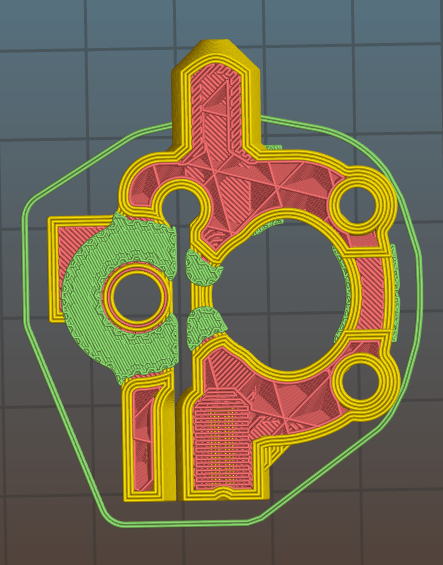

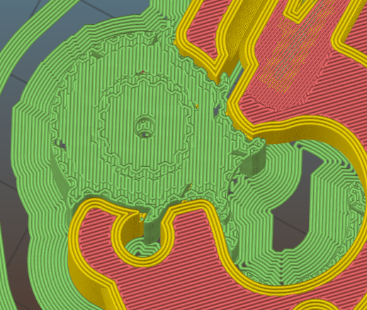

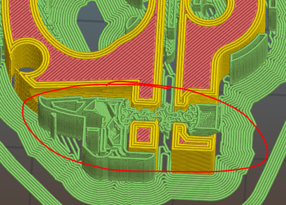

Here are two quick examples of difficult-to-remove supports (PETG with PLA+ support material):zemlin wrote:Would be helpful if you would spell out the nature of the shortcomings you're seeing in your printed parts.
The support for the bearing slot is almost impossible to pull through. How Slic3r wants to support the hole for tension adjustment. Prusa3D Slic3r has a similar feature to S3D where it will only generate supports from the bed but that means that it would try to print the bearing slot unsupported.

yeah, you're getting support in places there you don't need it or want it. I also use S3D - i've only printed a couple in ABS, but didn't have any significant issues pulling the support out. i will need to drill out the filament holes before i try using them, but they look better than the Makergear parts.

I couldn't believe slic3r was overkilling support like that, so I downloaded Prusa's just to see. Sure enough, with overhang threshold at 0, there's way too much support, including inside the filament path.
However, I set the overhang threshold to 1, and everything was nice. Support just for the bearing slot and some of the bridged access holes. Mind you this was for my slightly customized version of the filament drive, but since it seems like a slic3r issue, it should work for you too. No, I don't know why 0 generates loads more support than 1. Some sort of bug. I seem to recall having this kind of problem in MatterControl as well, so it seems like a common math problem for some slicers.
