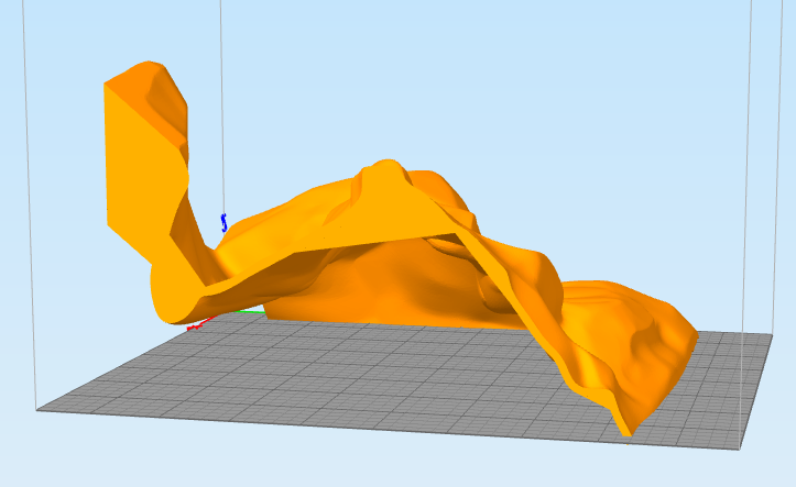

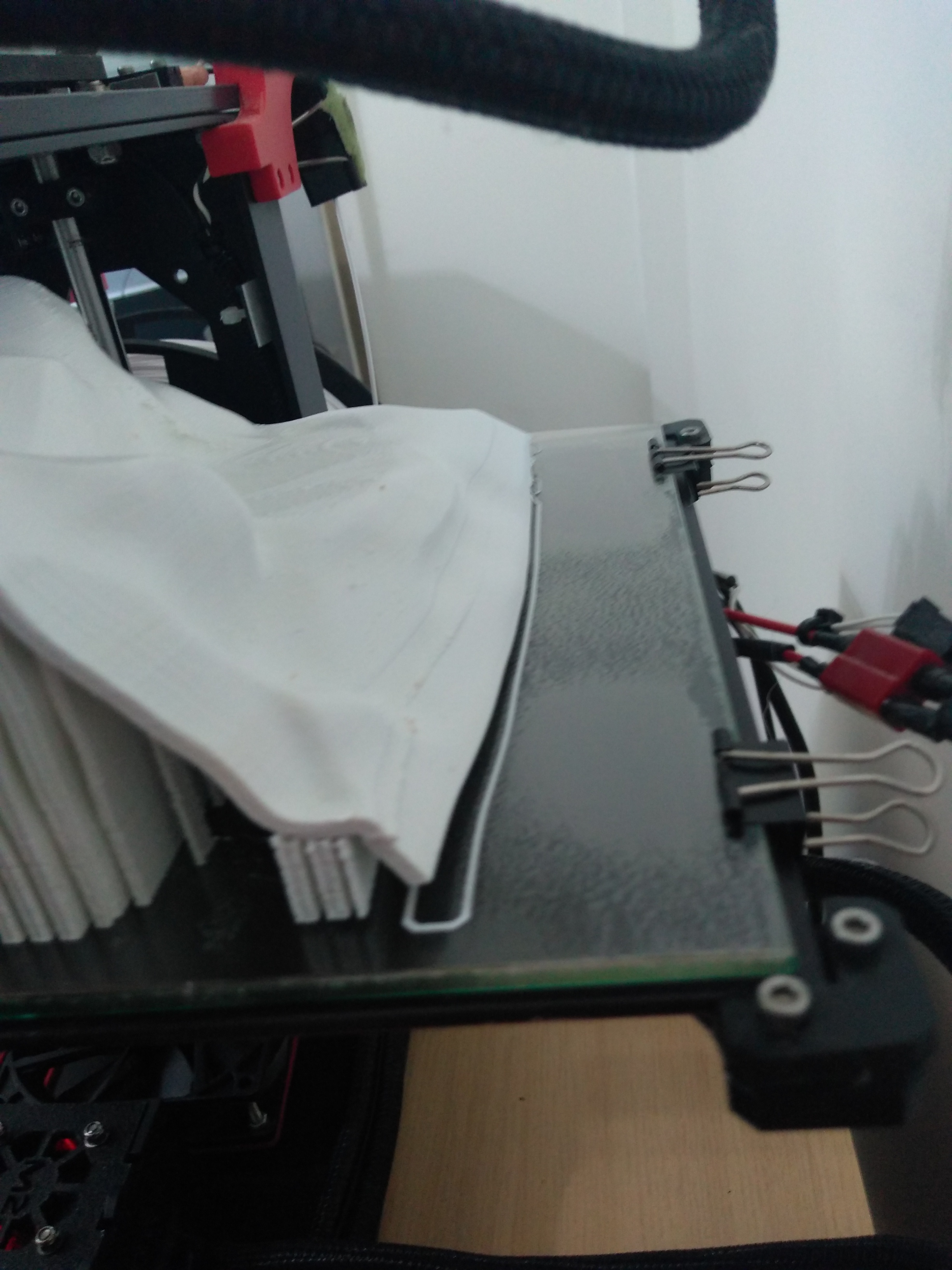

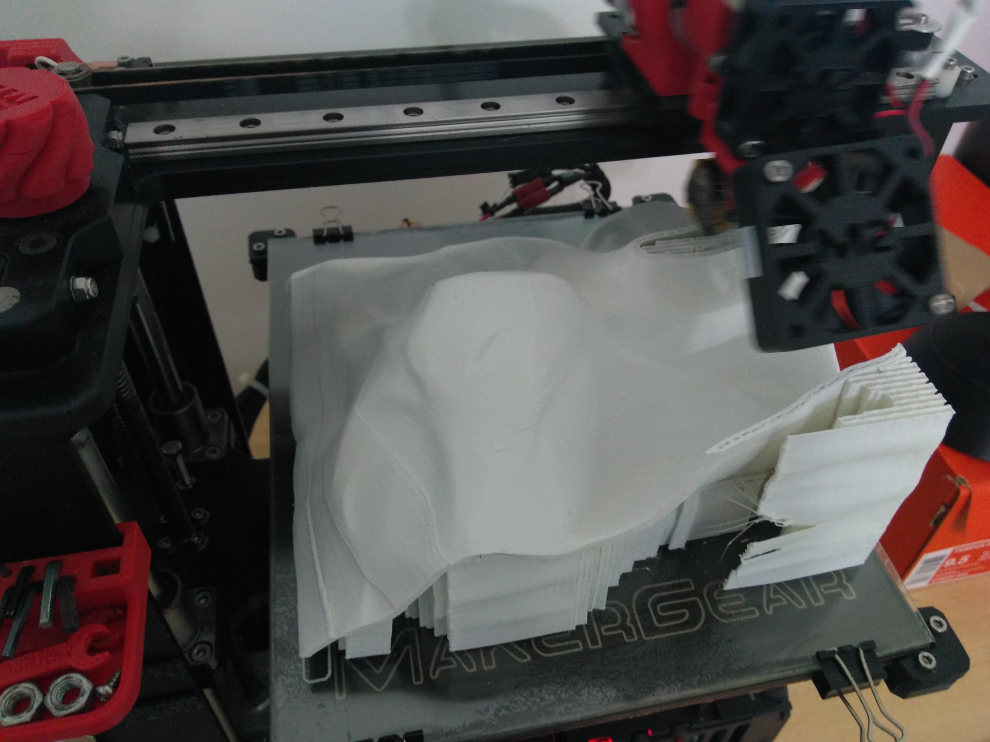

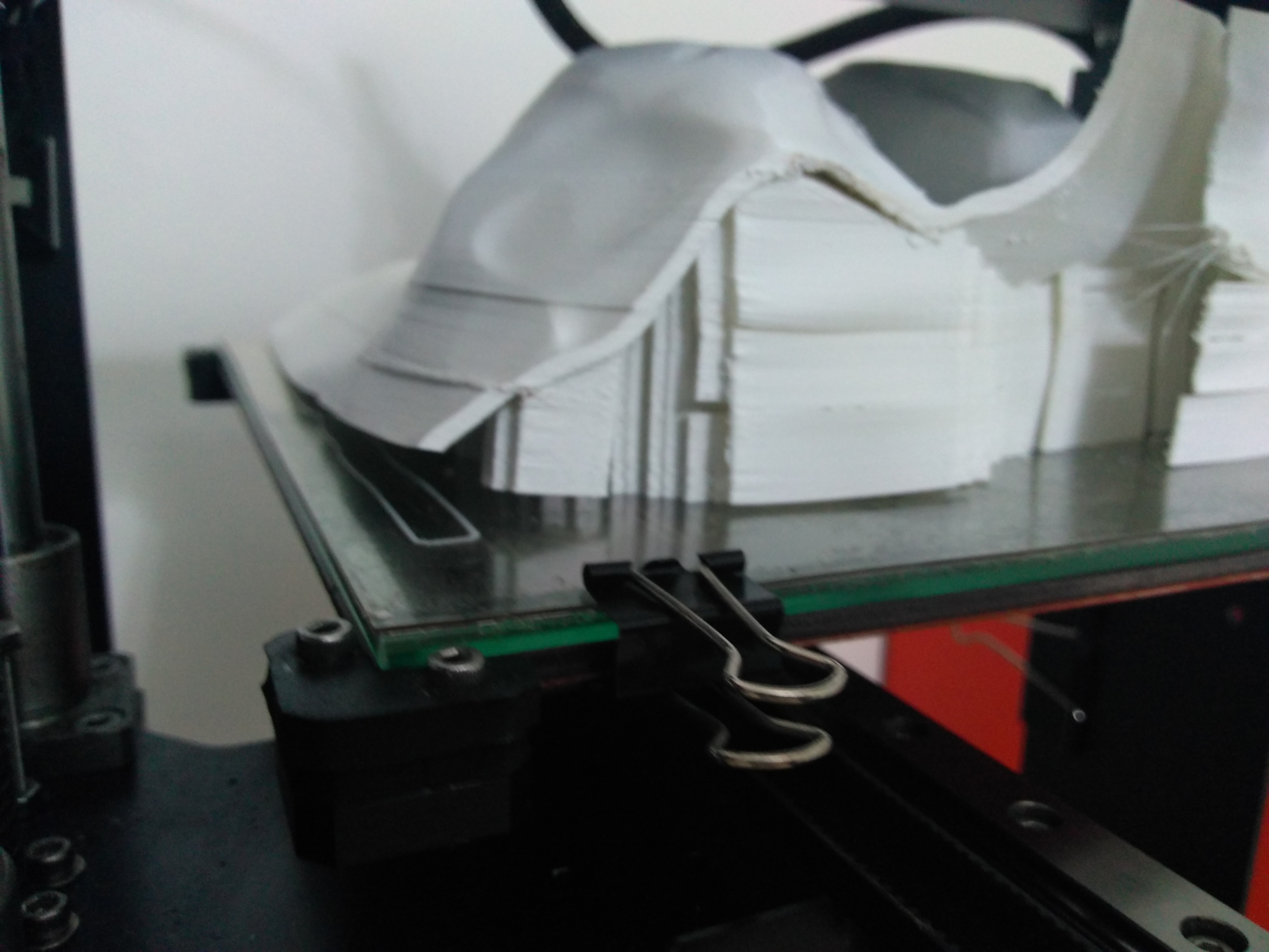

I have to print huge ABS prints (about 7,5" x 7,5" x 6", some even taller) and I'm having troubles with the adherence of the corners, after several layers printing: they start to unglue from the base and finally warping the base completelly (I can't get a plane base). The print completes, but with this issue. I also assume that dimensionally speaking, that print lost some height...
S3D view of the part
I'm using a .35 noozle, 260° for the plastic (I tried lower but I always get a clogged noozle), 80° for the bed (glass with PETG)... I'm also adding spray to the bed, since PETG only worked worst.
Is there a way to enhance bed adherence for this kind of big prints?
I was thinking in Raft... but I didn't want to use that, because of material usage and difficulty to separate it. I have to print 49 of those parts, so I'm trying to save material, in general.
Should I raise bed temperature? I never printed with PETG at higher T, maybe this case deserves a raise.
Should I create some "box" isolating the printed in ordert o maintain the T° inside? The medium time for priting those is about 20 hours... maybe could be a good option to avoid room T variations?

The short answer is that part is never happening in ABS.

Are you running the bed fan? In my experience, it is best to print ABS with the bed fan off to reduce warping such as this. Although, insta could be correct and you may never get this to stick to the bed in ABS.
Another idea would be to put a big brim on it. I have occasionally had luck with brims, but I try to avoid printing objects that large with that small of a footprint.

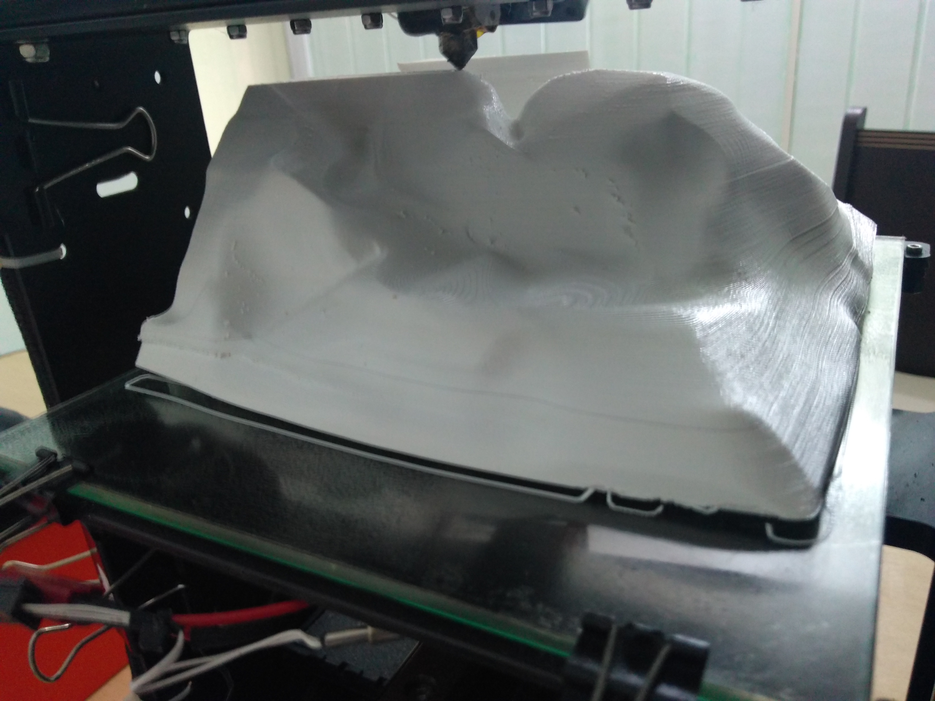

I basically got a way to print those big parts with ABS with some satisfactory result.
I'm using ABS because I need to work at the finishing with Acetone, that's why I'm not using PLA. PLA is a pain in the... in order to finish it!
With some brush and acetone, I can do magic over ABS parts!
The idea is to create a 1,30m x 1,30m frieze with 49 smaller parts. Therefore, I'll work on the finishing later.
First:
I raised bed T° to the maximum 120°, eventhough I'm using PEI. That way the first layers are better retained, and no warping is appearing. I'm seeing some warping (little) in superior layers, but not at the bottom.
Second:
I had to do some changes in the model: I've divided the model in two parts, with Meshmixer. Those two parts are located standing, with one of the 5mm's side in contact with the bed. That way I'm avoiding too much support material and also lowering the part height.
Third:
I'm thinking in isolating the printer with a box, but so far, I didn't confirm the need.
I'm not using raft or any other special additional feature.

Your best bet is to use a pei bed. Can you maybe make the print in sections. That would help a lot. It would also save you some material. That's a lot of support material you are wasting printing it in one peice.

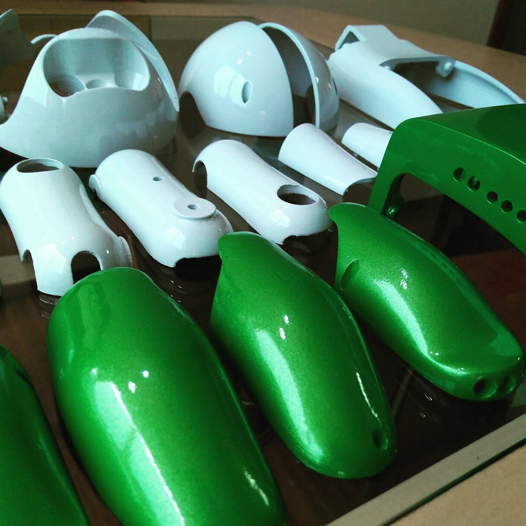

Olá! Those parts are printed in PLA 0,15mm, finished with primer, sanding and car paint. Finally varnish.
All together are part of a robot I'm printing and finishing.
