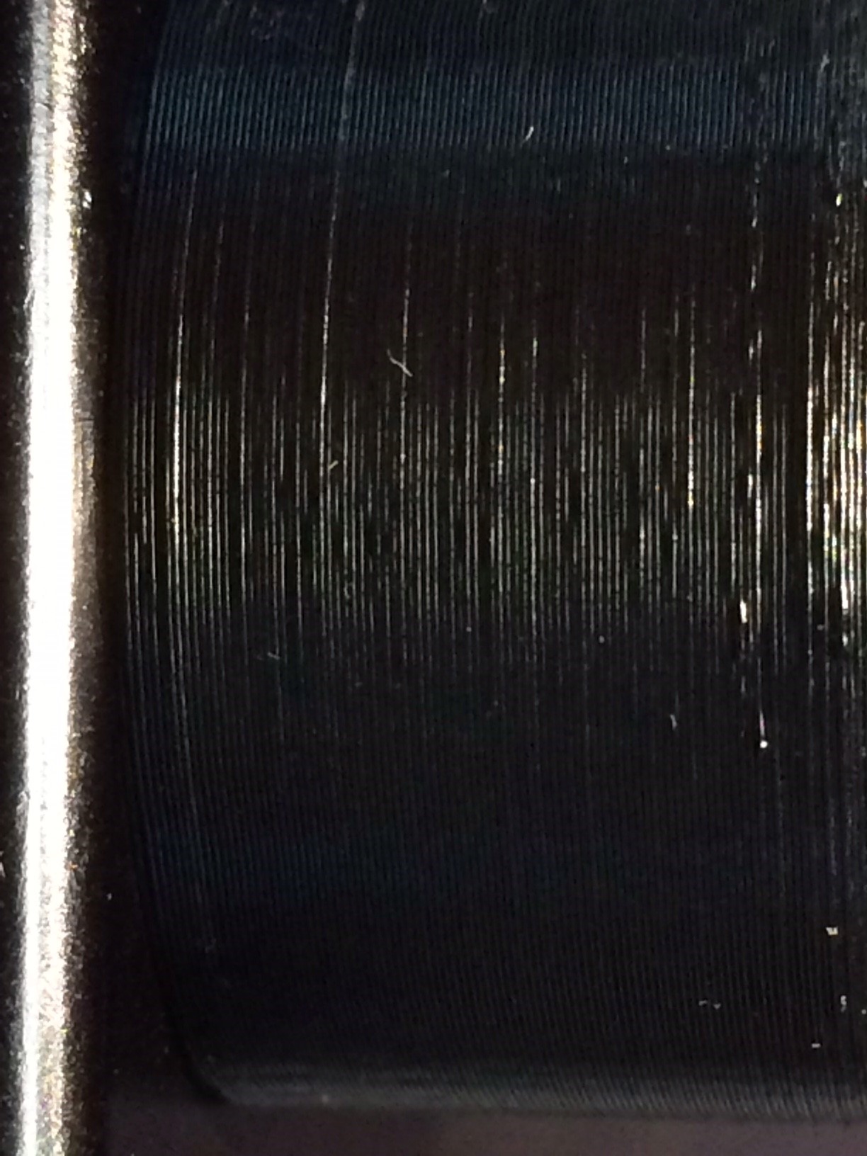

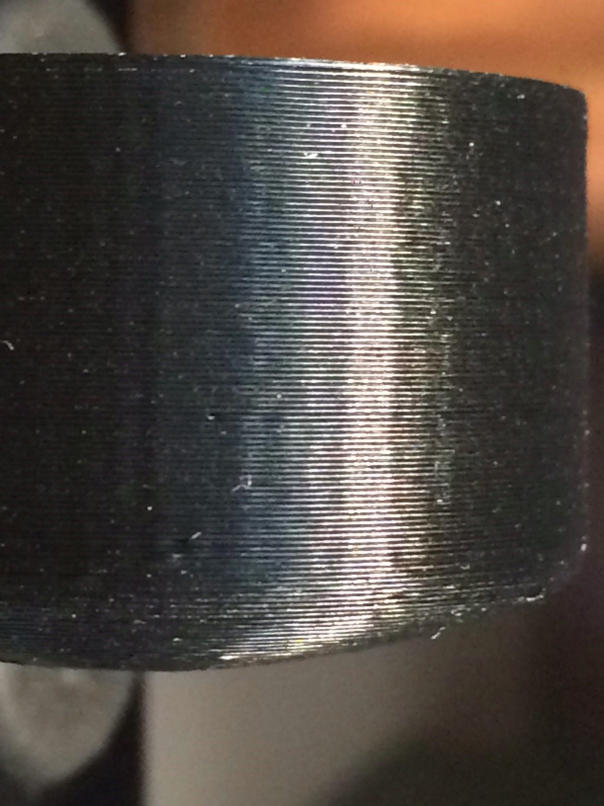

I printed some parts in ABS yesterday with a .165 layer height.
I did not get any banding on the magnitude you're seeing. If I light it VERY shallow with a point light source (LED), I can pick up a very slight irregularities. I don't feel like the banding you are seeing is characteristic of the M2. It's not a perfect surface, but it doesn't have a pattern.
Here's what the part looks like under normal light. and if I light it to make it as ugly as possible
