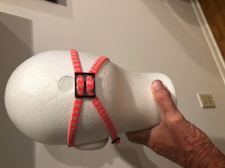

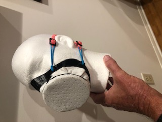

I use Simpify 3D on a MakerGear M2 printer. I now use a hair band through the side holes and loop them. Then I take a head band and cut it and connect it to the loops with a clasp I made. Really comfortable. Let me know if you want images of final product.
Tom
Tom
