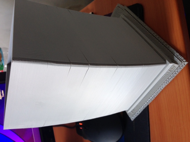

Hey all,
I am currently using a glue stick setup with a ikea box enclosure. I am also using the 50mm fan mod to put it on the back of the stepper drive (pulls the abs). I am getting a fair bit of this cracking. I know this is a large straight part, but is there anything I can do to make sure this prints without these cracks? I am also a bit fearful that the stepper motor will overheat in long prints (>14 hours) so I keep the enclosure slightly open and keep the room at a cool temperature (75 degrees), but it doesn't seem to be enough.
Need someone to come up with a liquid cooler

Re: What causes this kind of warping with ABS?
Are you running that fan during a print? No fan for ABS.
There's limitations with ABS. Large parts is something I'm not even going to try.
14 hour prints are beyond my experience and patience level.
Printing with PET+ is more stable, stronger and not sensitive to heat warp-age.
I am running that fan (50 mm aimed at stepper) during hte print, but it does get very hot during prints.
Is PET+ the same cost of ABS? I'm printing very large pieces (starts at 8 hour build times, up to 24 hours) and plenty of them (33 pieces in total)
no cost to buy the pet is double that of abs but how much abs have you wasted in failed prints by now. what you are printing there is not going to work with abs. enclosure or not. for an enclosure to work it needs to be up around 70-80c. what you have helps for sure but it wont cure the issues of needing a heated chamber. your options at this point are pla and pet.
