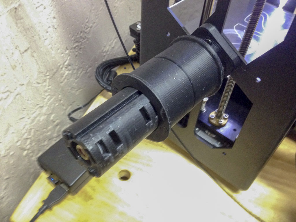

Ok markb its ready. If you decide to print the spool adapters you'll need to wire brush the interior diameter a little so they go on tight but not too tight. I'd still put a clip on the spool holder just in case they loosen up after some use.
I'll add more adapters as I run into the various sizes. I have an idea for an attachment for the small taulman holes. Whenever I buy my first Taulman I'll make it.
http://www.thingiverse.com/thing:523415

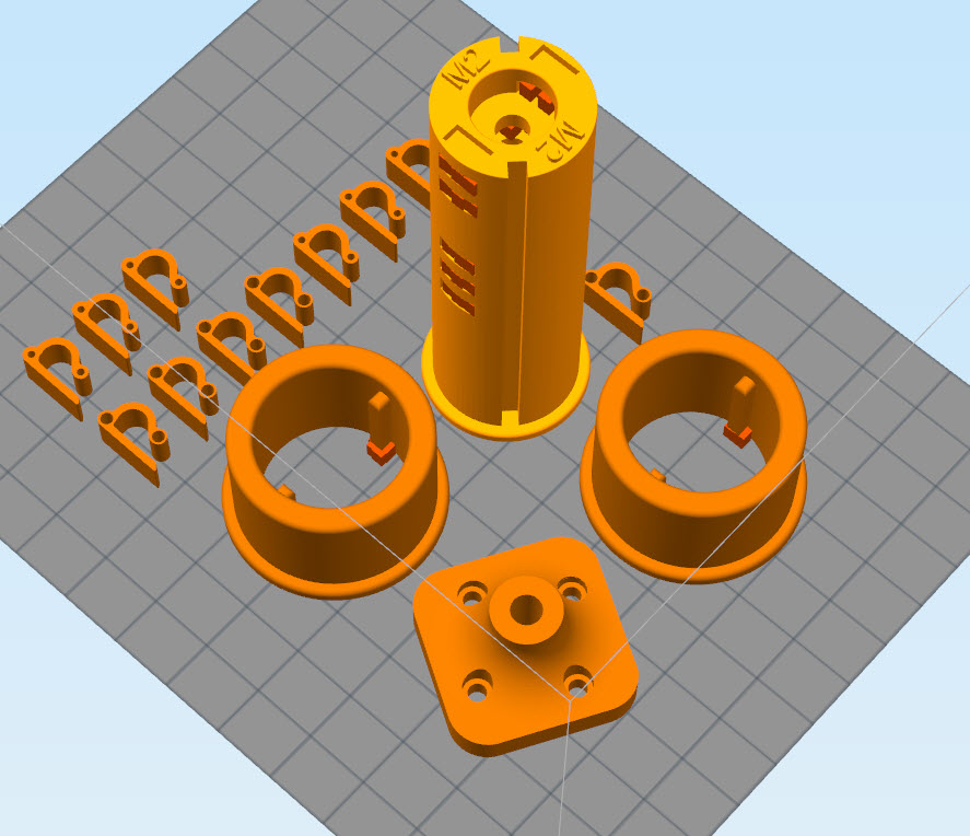

Includes spool holder mount, spool holder, spool holder 52mm adapters, and clips
M2 Spool Holder Kit Ver 1.2.jpg (132.69 KiB) Viewed 17427 times
The 52mm Spool adapters can slide in the groove for different width reels.
2014-11-09 18.11.37_1.jpg (172.24 KiB) Viewed 17427 times

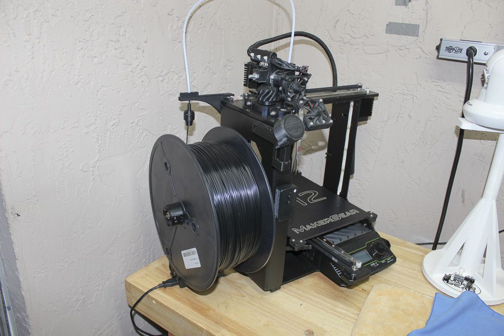

Show here with a narrower reel...
2014-11-09 18.12.48_1.jpg (159.59 KiB) Viewed 17427 times

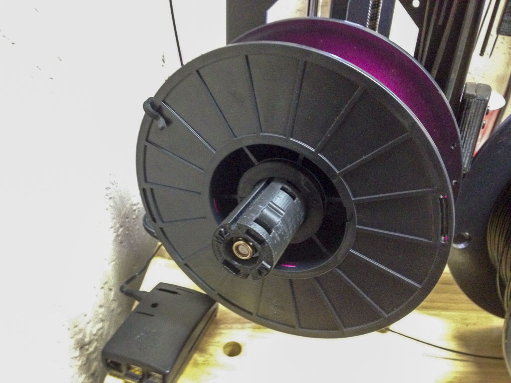

...and here with a wider reel
2014-11-09 18.15.07_1.jpg (170.72 KiB) Viewed 17427 times
