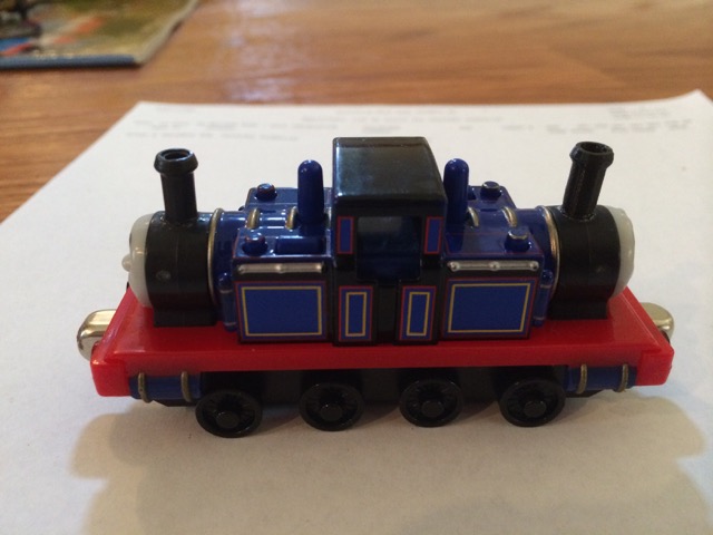

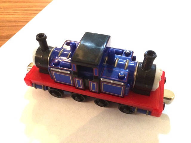

Here's an example of a small cylinder. The train is a Chinese knockoff of one of the Thomas train engines that had a smokestack knocked off. The printed replacement is the one on the right. I forget the exact size, but it's probably something like 5mm in diameter. Printed it as a single, so there are no issues with cooling in PLA if you print slow enough.
What will give you some problems are spheres. The bottoms are unsupported, so it is difficult to print them at high quality in one go, and the smaller you go the more pronounced any defects are relative to the size of the object. If you are planning to use them as bearings, I would just design around a real ball bearing.
