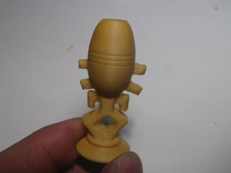

tim, i used my esun wood filament sample to do a test print to see how it worked out. i had no hiccups with printing the stuff. it extruded just fine and right out of the gate i printed it at .08 layer height. i took my horga'hn model, shrunk it down to a total height of only 2" and tried printing that. i was really amazed at the quality and how smooth this stuff prints. you cant even seen layer marks at all. the only marks on the model are from where the support was touching it and i had to do some cleanup in those locations. here is a pic. keep in mind here that the head on this model is only 1" tall.

The wood print certainly looks nice; however, in the photo it has a sort of root-beer color and a sort of translucent look to it. Is that just an artifact of the photo or does it really look like that? I've heard that by changing the temperature on the nozzle as you print, you can make the colors change and give it a more wood-grain-like effect (the hotter the temperature, the darker the result; basically wood-burning on the go. . .). Most of the pictures I've seen of wood filament prints look sort of like something carved out of masonite, which does not exactly look like wood, but I think is pretty reasonable considering that it was dripped out of an extruder.
