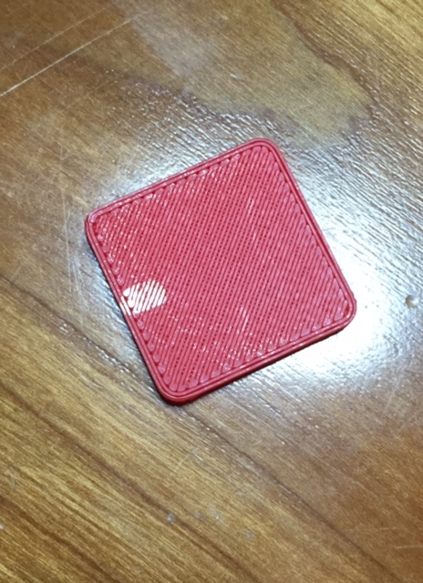

btw going back to -20 gets me back to the correct height...but I notice the lines in the bottom of the calibration square...maybe there is an infill setting I should be playing with??
Re: Stringy bottom
Post a closeup picture of the bottom of the last square, let's take a look......scampa123 wrote:....btw going back to -20 gets me back to the correct height...but I notice the lines in the bottom of the calibration square...maybe there is an infill setting I should be playing with??
Re: Stringy bottom
Here it is!! Is this bad? It's not a glassy bottom for sure..Jules wrote:Post a closeup picture of the bottom of the last square, let's take a look......scampa123 wrote:....btw going back to -20 gets me back to the correct height...but I notice the lines in the bottom of the calibration square...maybe there is an infill setting I should be playing with??

Hmmmmn - that still shows that the bed is a little too far away. (Much better than it was, but there is still some under-extrusion.)
Let me ask you another question - what extrusion width did you set? (0.40 mm?)

yes still too far away. move it about .05mm closer and try again

Yes, 40mm manualJules wrote:Hmmmmn - that still shows that the bed is a little too far away. (Much better than it was, but there is still some under-extrusion.)

Yes but if I do, then the height of my calibration square will be off...jimc wrote:yes still too far away. move it about .05mm closer and try again
Maybe I should adjust the bolt and use a .1 or .06 feeler gauge instead of the .15?
Also, when I set the Z via the bolt, I'm doing it with both the bed and the extruder fully heated for ABS at the temps I print at...I assume that's correct from what I've read on the forum
