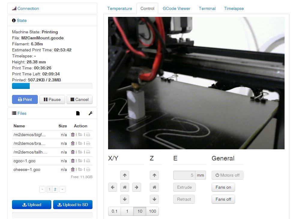

I have my webcam working on it now. It shows video on android. Windows 7 it only shows video on Chrome not Internet explorer? On IE I just get an X where the video feed should be. Any idea if it should work with IE?

what do you have in the your Controls" tab ?
- OctoPrint.JPG (90.13 KiB) Viewed 17957 times

I added "Get Position" to my controls, but don't use it as much as I thought I would, probably because with the camera working I can just see it.
I just checked and have the same issue with IE on Win 8.1, but I'm a Firefox guy followed by Chrome so I have no idea why. One thing I'll forwarn you about is later when you get into timelapses I found that Windows Media Player does not play the resulting video file and when I asked about this on OctoPrint they just told me my video player (Windows Media Player) is broken. I didn't find that totally satisfactory, but installed VLC and it plays them fine.
I'm not sure a camera mount hanging off the M2 itself is going to be the best. I've found that I like the camera in front of and to the right side of the printer and back enough to see the full bed when it's at the bottom. The right side allows me to see the filament extrude off the right side of the bed when its being primed at the begin of a print so I see things are going well. It also gets the filament spool in the frame so I can see the label on the spool going around in the timelapse - somehow that feels useful. Currently I've got the webcam on a big floor sitting tripod in front of the table the M2 is on. When I build a custom cabinet for the M2 I'll make some arrangement for a camera stand built into it.
