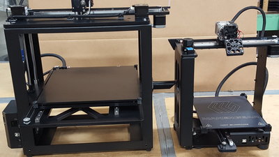

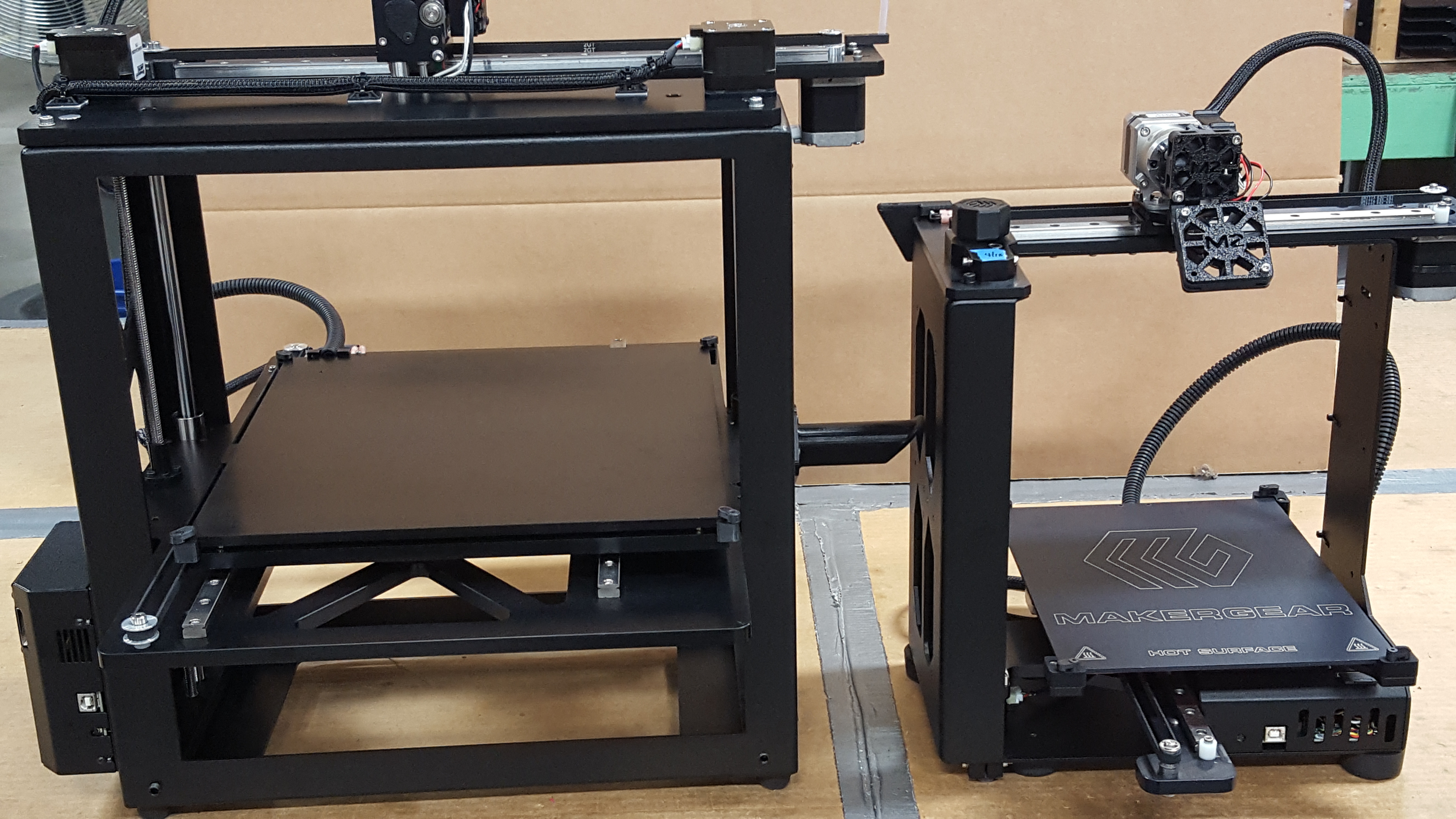

Here is a side by side of the M4 with an M2. It has been, off and on, in development for about a year.

Rick, it looks like there is no z knob on the m4! It must be on all machines! I use this so often it would be terrible to not have it! I even account for its use in some of my designs.rpollack wrote:Here is a side by side of the M4 with an M2. It has been, off and on, in development for about a year.
Perhaps instead of using two ball screws you could just use the same m2 design and make it more robust with larger diameter and slightly longer guide rails paired with a beefier spider... or just bottom mount the motors and have two z knobs, better then nothing. I see other machines occasionally have issues with using two z screws (ie both screws arent exactly the same in straightness or dont equally/accurately turn together, things that may be difficult for you to notice before shipping them out)
As for other thoughts, It looks like the extruder pokes through the top of the frame? How will part cooling fans be used in this design? perhaps from the top thats funneled cleanly down around the extruder drive? Also this makes it difficult to see your first layer, which I really despise about other printers
I do like the board removed and to the side as it minimizes the risk of filament purging in to the fan. Also I've never much cared for the USB cord sticking out so far out front of the machine being further back helps with that.
Do like using two rails for the y axis to greatly reduce play. Hopefully with stainless steel bearing carriages so we dont need to upgrade them ourselves
Would greatly prefer if you ran the second z motor wires under the top of the frame as it would make it easier to clean the machines
Without a doubt this needs to have dual heads as well. Preferably with software capable of printing two parts at once as I noted previously.

I like the M4 a lot. Is there any intention to make it independent dual extruder as well? How difficult do you expect that it would be to fit up a titan and v6 on it, now that things are a bit tighter around the hot end?
Things I like about it:
-Dual Z steppers
-more robust frame
-electronics box on the outside of the frame makes it easier to enclose it
-larger footprint and wider stance in terms of the feet for stability
-THE BUILD VOLUME! (the first questions that customers ask are usually 1.how big can you print 2.can you do color)
-dual Y rails
If it goes into production, when would it be available and what price point?
-Dual Z steppers
-more robust frame
-dual Y rails

m4 looks great. its fantastic to see dual linear slides for the bed.
Re: The State of the Gear
Wow, that M4 looks like a beast. Fantastic design work!

creativedex wrote:Rick, it looks like there is no z knob on the m4! It must be on all machines!
Digging the M4 for sure. I have made a habit of pushing the M2 X&Y area to the limit. Currently don't have the budget for a big upgrade, but there is a potential for some good paid work on the horizon.
